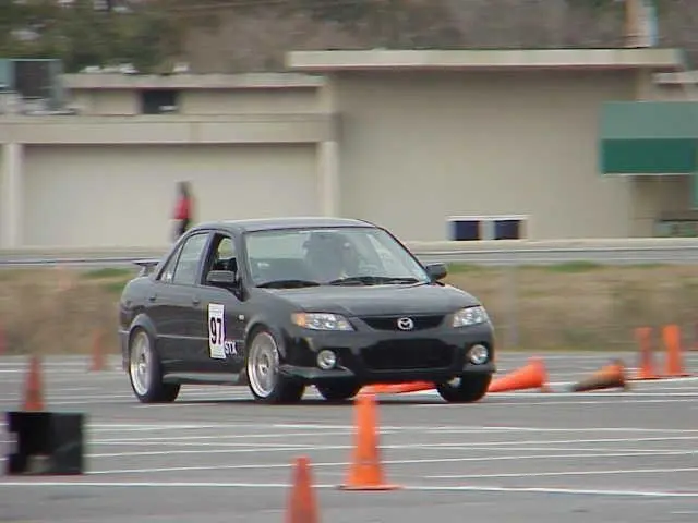

First the latest news, we just finished our third event of the local SCCA winter series event. Times were added from all three events. Between each event, we added a prototype component. The Delsing Motorsport project STX car took fourth overall, beat only by a viper and two z06 vettes!!!! Placed first in STX, if you have been following, we were closing in on last year's reigning top STX car, the M3 bimmer. Well this time we beat him on a very fast road race type course, by over 1.5 seconds! We are almost finished our development, will be installing billet trailing arms in the rear, we designed, and upper rear mounts, this should let us get the rear end set up correctly. Many spectators were really surprised! Praise God, HE is the one who gives us the talent!
