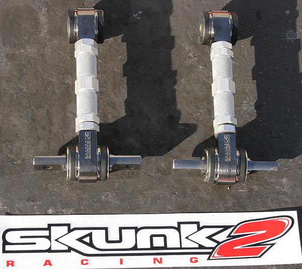

anyone think these can be fabb up for the MS6? they look pretty good.. some good R&D and testing would be awesome.

Front camber is done through the ball joints, rear camber is done from the subframe? I've been questioning this myself, but there aren't very clear answers out there.
tuner... this is sorta what we have for the rear that's connected to the rear subframe.. this is used for camber adjustments. toe adjustment is made on the lower arm where the cup/spring resides.. best thing to do if u want to know what and where to adjust is to watch the alignment guy do the adjustments and ask.. that's where i gathered my info..

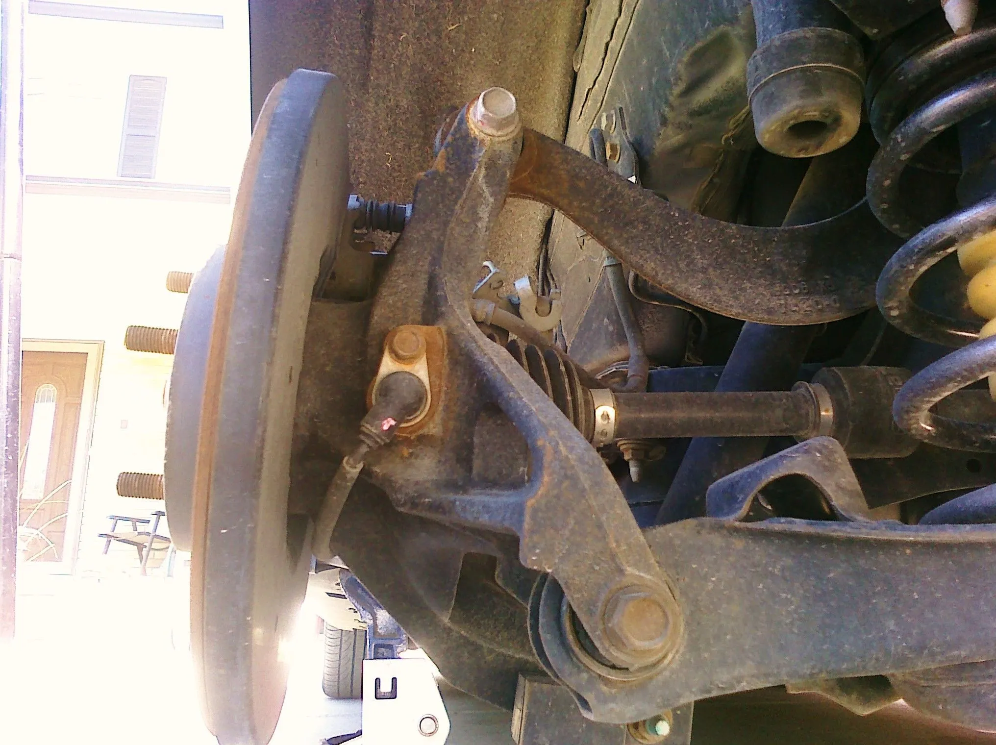

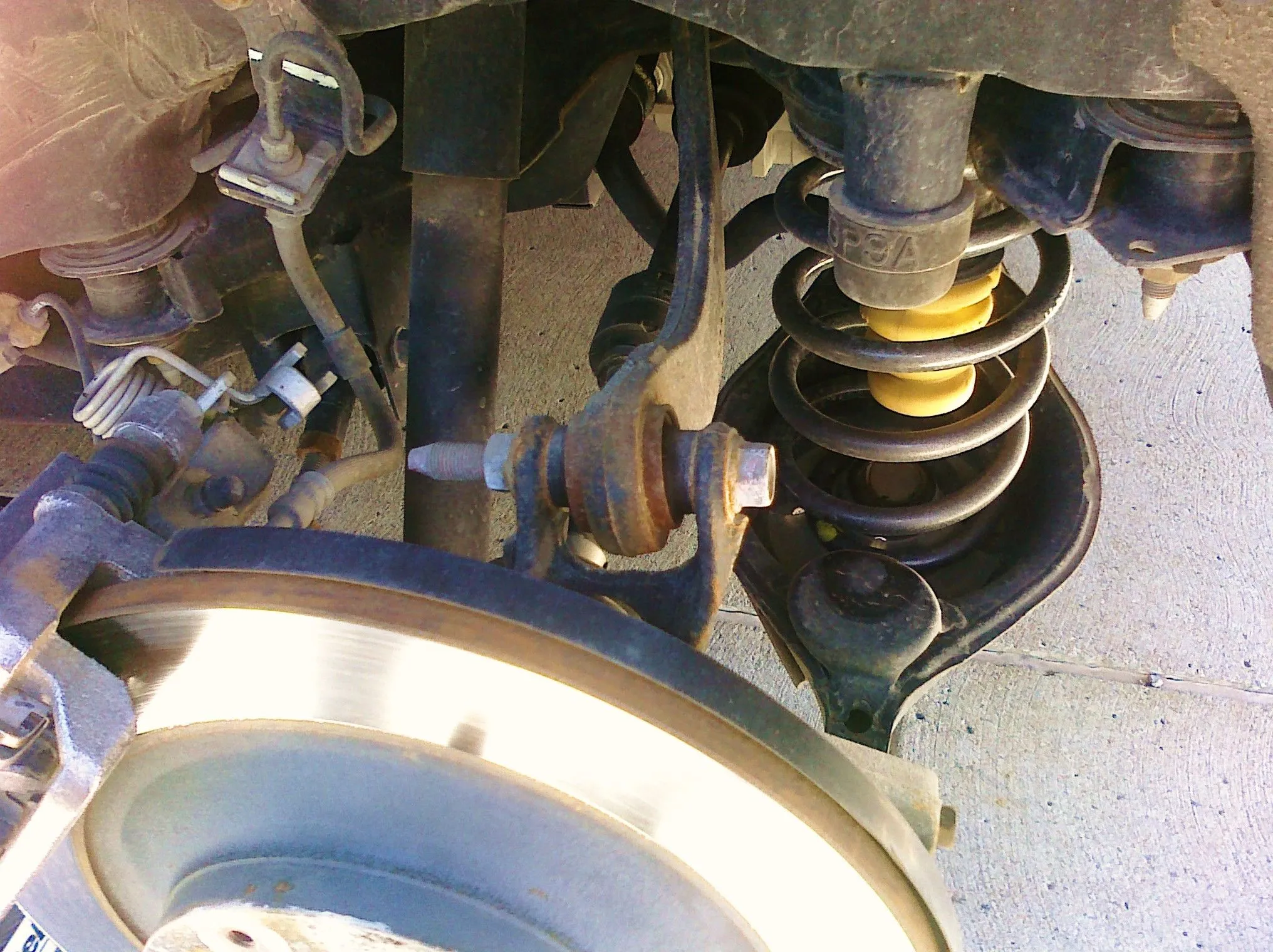

Chief, I know we've talked about this before, but where exactly can you adjust the camber on the rear of the car? I had the wheels off and found the upper camber links, but didn't see any adjustment on either side of them. If you could, can you post pics?
Here are some pics I took when I was rotating my tires...these are for the rear suspension:

Here's some more info on adjusting rear toe/caster:
Yes, camber and toe is adjustable on the rear. Camber is from the eccentric bolt at the inner (lower) control arm pivot and the toe link is just ahead of the rear spindle itself, connected to the trailing link.

Okay, I lost the software for our scanner when moving stuff over from my external drive, and my wife doesn't know where the CD is for it. According to the FSM, the adjustments are as Steve said. Camber is an eccentric bolt on the front of the control arms (they have a head which is marked), while toe is adjustable on the lateral links. No mention of caster so that means all the people who have written that the rear caster was adjustable were mistaken.
