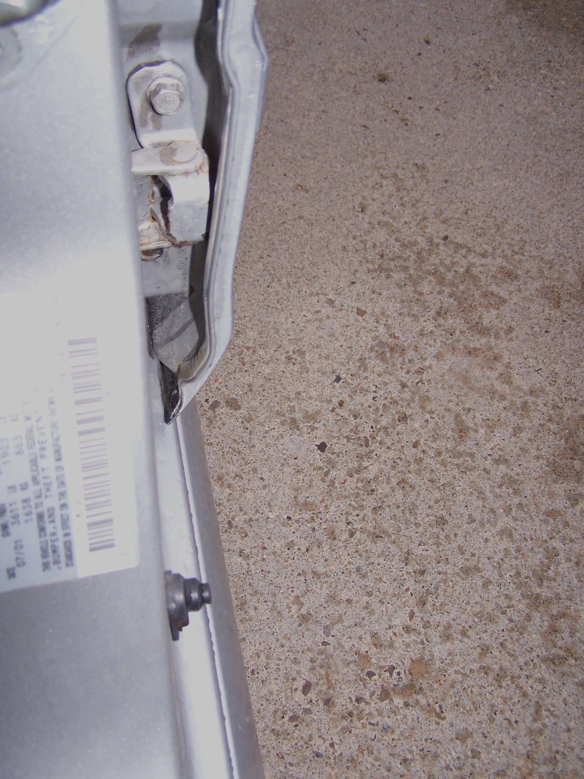

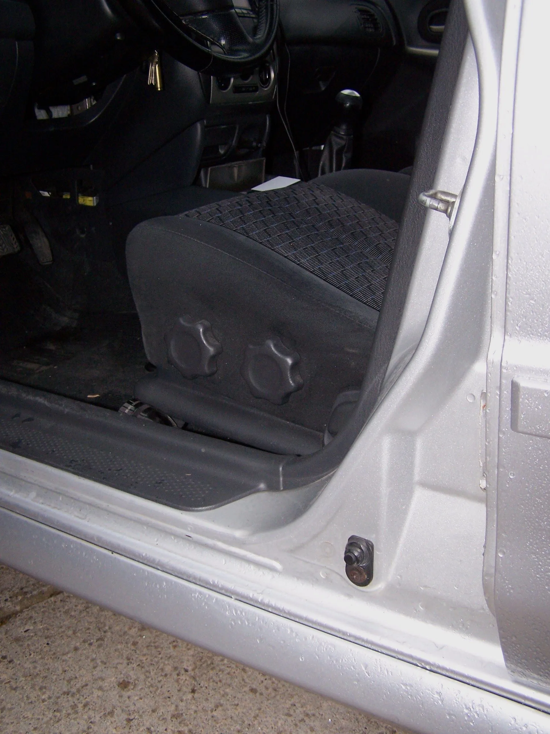

LOL, OMG Flash, you've got this poor guy pushing the wrong button!! Here's the right button. It's the one on the pillar on the bottom right of the pic. It's black and covered by a rubber boot. Push that as you follow the instructions. When it says "on" it means the position that your key is in according to the ignition switch. Look at the switch and you will see the "on" position. DO NOT start your car- you will not turn it that far. This position is the one that ppl use to run their radio w/o starting the car.

Here's the attachments. Flash can you point me to a how-to or pm, tell me how to put photos in my replies, without having them as attachments- like how Gr does it?
first one is from the side see the black button, thats it
2nd is sitting in the drivers seat looking back and down as you would if you were doing the chart.

Really!!! LMAO! How did you figure that one? Well Ill give that a shot. Thank you tukalama!
NP dude. If this don't work and you changed the batteries, order a new (used) one from ebay.
I figured someone had to step in before Flash had you sticking your finger in a light socket. Oh btw he's from the eastern side of the state, us'n smart folks are from way out west by West virginia
Woohoo!!! Worked first time! Thanks again Flash5 and Tukalama! I say thank you alot dont I. LOL.
