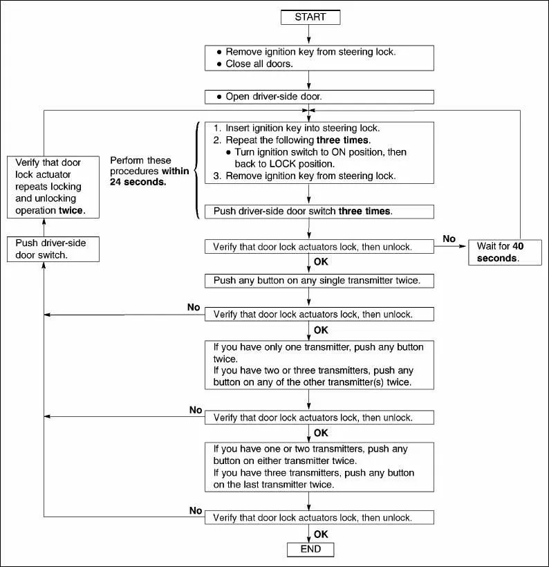

you can get them for $5-15 on ebay... I had the program instructions uploaded somewhere...hmmm
edit: found them

Well, I guess that begs the question then, can you change the battery in the remotes?
I really think that is all that is wrong with mine.
yep, thats why it'd need a new battery, I used the original one in my current remote. Remove the key ring and there is a spot to pry the fob open exposing the battery. replace and let me know if you need this other one.
(hand)
Taking it apart was easy enough... I just didn't think that you could from looking at it.
I'll be picking up a new battery on the way home tonight.
One more stupid question.....
I replaced the battery but no luck... do I now need to reprogram?
no, you shouldnt have to. I've replaced batteries on the key fob on either of our proteges and it always worked after the fact.
not being a dick but, Im guessing the battery is in there correct?
lol... as far as I can tell it is in there correct.... + facing up.
