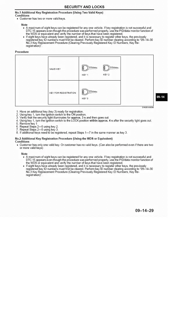

I have not tried any, but this *might* help. Saved it some time ago from old posts....
  • MZ5_key_fob_program.pdf
I had no problem programming the key using the instructions posted by coolmazda5. I was unable to program the remote purchased on ebay. I have since learned that the electronics in the remote were changed for the '07 model year.

I think what Benfolio means is it is a blank key that has the chip in it. It does NOT have a remote. I bought one for my 2008 5 for a little under $25 from my dealer and he cut it for my car. I used the programming described in a previous post here (where you need your two original keys) and it works fine. It unlocks door (using keyhole) and starts the car. I just use it as a spare for emergencies or when loaning the car to someone. It DOES work on my 2008 5
I ordered the blank per Benfolio's guidance from onlinemazdaparts - expect it in a couple of days - look for my report as to success or failure soon after.
Success - Easy as Pie - Total Cost < $20
(yippy) So I got my blank key last week from www.OnlineMazdaParts.com - for $18 and change (it shipped with a few other items that totaled more than $100 - so shipping was free.) It cost me $1 + tax to have the key cut and then I followed the instructions coolmazda5 posted earlier in this thread.
Time taken to progam the key? About a minute.
Now I have my third key for less than $20 bucks - amazing!
Thanks again to everyone who contributed -especially Benfolio and coolmazda5 for having the key information I needed!
