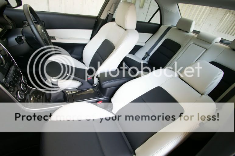

Truth. I have Sand Leather, which is practically an off-white. I wear dark jeans often. I wipe down my seats weekly to keep the dye from embedding into the threads of the stitching and the coating of the leather. At times I wish Mazda did a two tone scheme with the seats. Black bolsters and white centers.
Keeping the leather "conditioned" and protected will also work against jean dye rub off.

Mmmmm...yummy.
