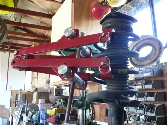

Now that you have the struts off you need to replace the springs. To do this yourself you need a spring compressor which you can rent or borrow, but probably you are better off taking the struts to a shop that has the right tools. It will take them about 15 minutes and shouldn't be more than $20 or so.
you can rent some compressors from autozone for 20 bucks and its fairly easy. me and my friend did that when we lowered his srt4 and a typeR teg and a civic. its not too difficult.
