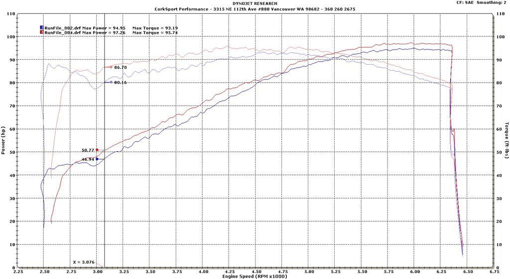

Here is the dyno sheet we have posted for our intake.
-Derrick
Thank You Derrick! That was me that called you yesterday like 3 times asking about the exhaust legallity in TX haha. Thanks. Any dyno info on the exhaust? I already ordered it but the info may help others looking into your products.
I've got a CS SRI and a custom fab'd 2.25" single resonated exhaust and I make 113hp at the flywheel up from 98hp stock. I've got dyno charts posted somewheres around here!

thanks for the advice... will do. I'll keep you all posted. Keep an eye out for Mykflo's 2 thread coming soon.
