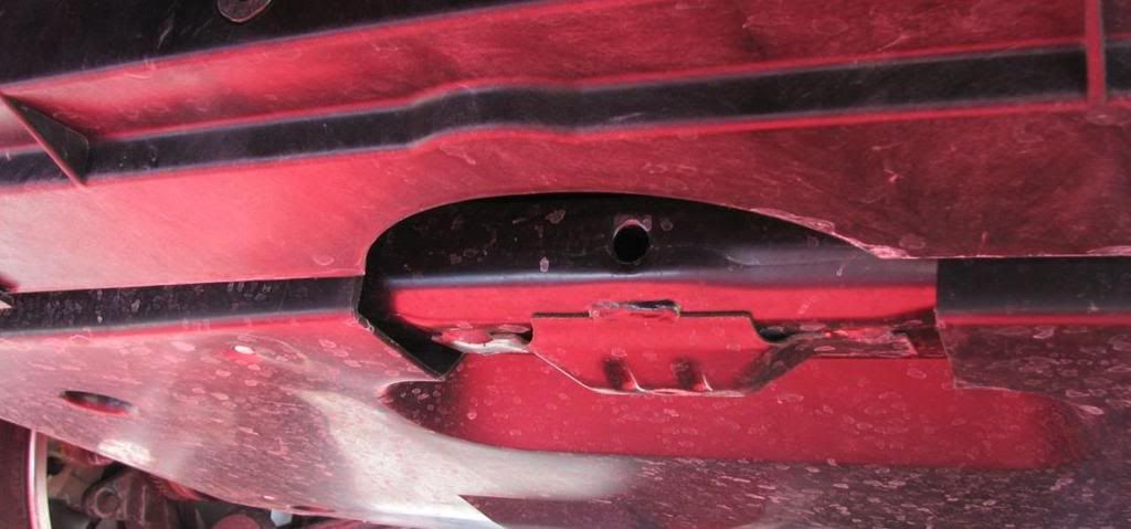

Here's the front jacking point. Fairly easy to find, thanks to the obvious semicircle cut from the plastic (pic stolen from another thread):
The rear is not quite as obvious. It's to the immediate left of the y split in the exhaust, and to the immediate right of the pivot point of the left lower control arm. Once you get under there and look, it's be a little easier to figure out.
