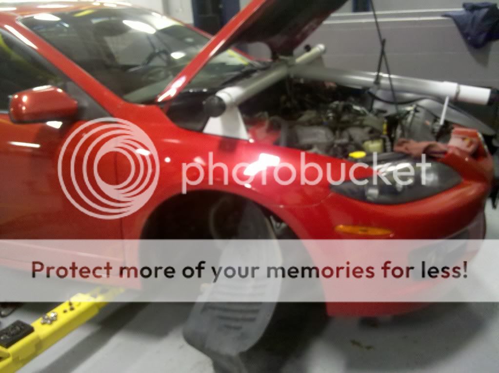

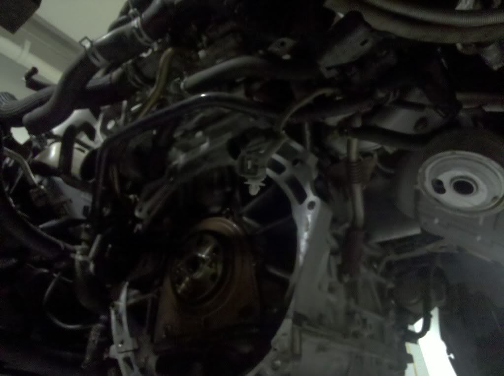

I'm a tech myself... and happen to have a 2006 MS6 torn apart at work for a clutch and resealing the t-case...
I don't think the parts will be in until later this week, and probably won't be running until Friday, possibly Monday(the Mazda dealer we use for parts isn't usually very good at guessing the ETA in my experience(jerkit)).
It is a customer car so I can't drive it to you, but I will take note of any ticking noises heard when it gets started up again. I drove it about 30 miles before tearing it down, and definitely never noticed any ticking noises inside the cabin though.

Hey that MS6 finally got buttoned up today at work... I completely forgot but this thing has direct injection... it's going to be noisy as hell and make a tapping noise.
It's noticable when sitting in the car at idle with windows down for sure... with windows up you can hear it a bit... it's not like a midget with a sledgehammer under the hood or anything though.
Direct injection is noisy because of the injectors they use and the pressures they operate at. I honestly have no clue what the Mazdas operate at... but Cadillac direct injection is something silly like 2000 psi.
Unfortunately I would say if you have any valve noise, it would be relatively tough to distinguish between it and the injectors.
Have you taken a stethoscope to the valve covers?
FWIW I took video of the MS6 running at idle, but my phone muffled the noise and it is not nearly as loud as it was in person. There is a distinct tapping noise(like taking a bamboo chopstick and smacking a table repeatedly) which is normal.
