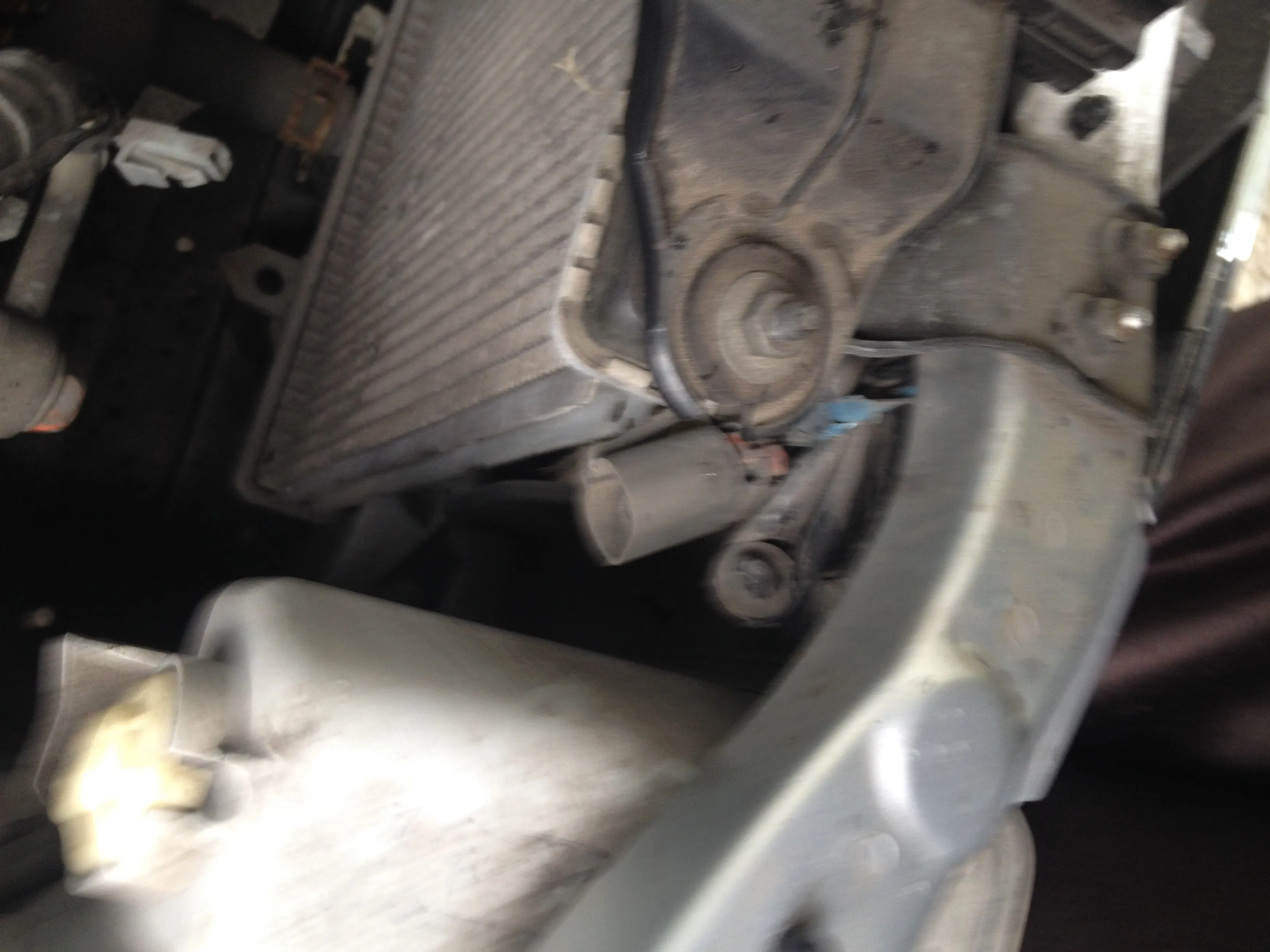

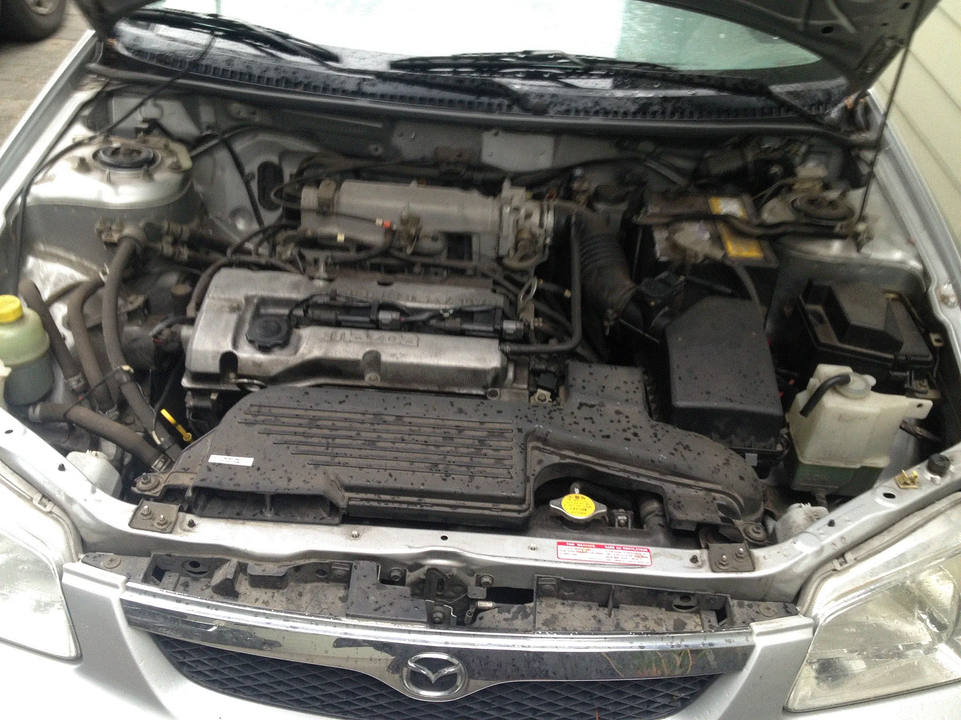

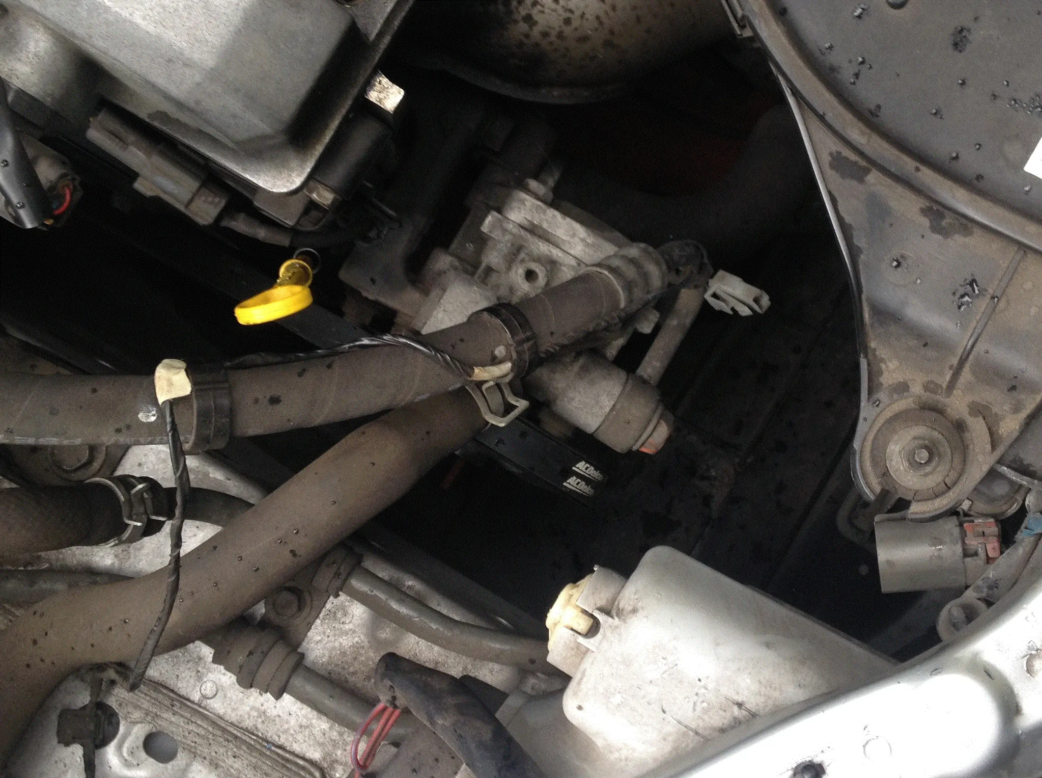

As you can see, there is a two wire connector that is around the steering pump and is white, the other connector is near the rad and is a four prong connector, the third pic is of the engine in general. Two wire connector by steering pump.webpFour wire connector by radiator.webpEngine.webp

I think those two connectors you are seeing in the engine bay are for the A/C fan and the A/C compressor clutch. By the looks of it your car doesn't have A/C but the factory harness is one harness no matter what options you've got. I'm having a similar issue now with bogging at tip in throttle especially when the car is cold. No code same as yours, I checked my MAF sensor voltage on a scan too and rather than being a standard .5 volt to 4.5 vilt range it starts at 2.5v and goes up from there. Meaning the car is measuring way too much air and compensating.
