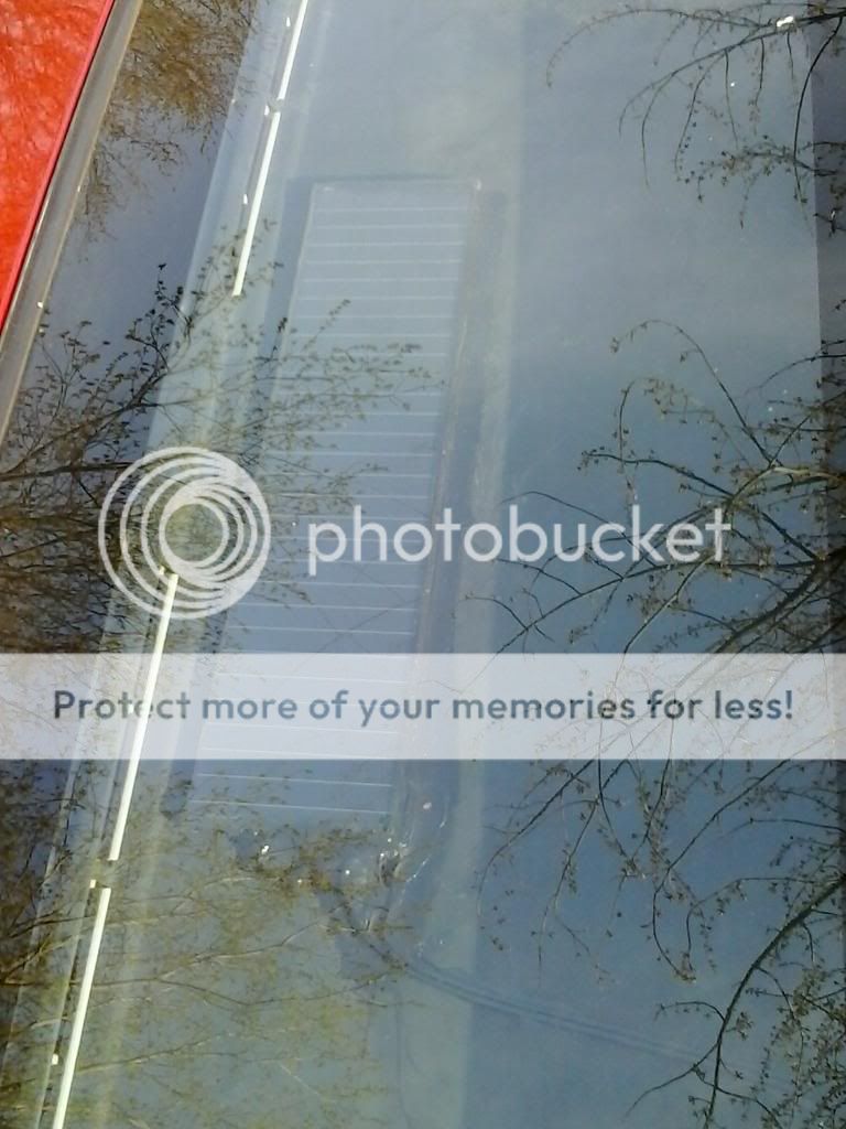

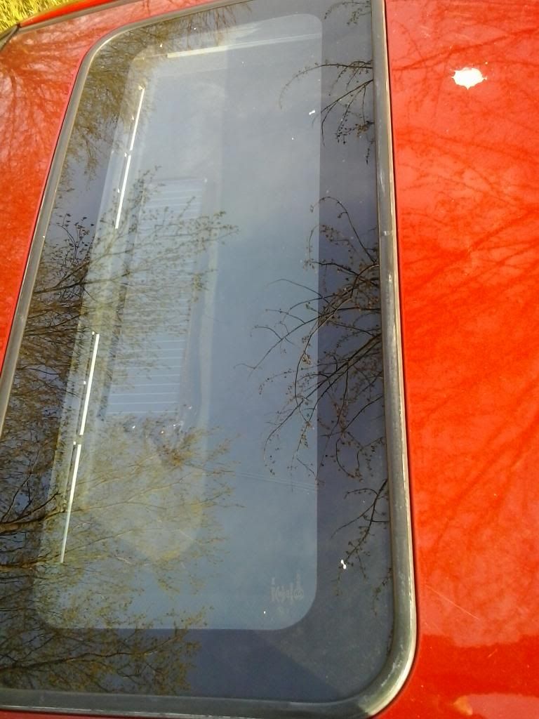

I also did this "mod" to help keep the battery topped up. It's wired into the interior dome light. (one power wire in the light switch has constant 12V so the solar panel will charge with the key out)
