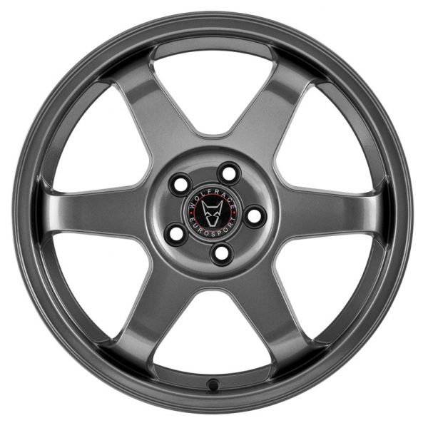

Couldn't help myself. I've ordered a set of these 17x7.5 with tyres.
I'll post photos on saturday :D
The 17s will definitely bring a more comfortable ride
