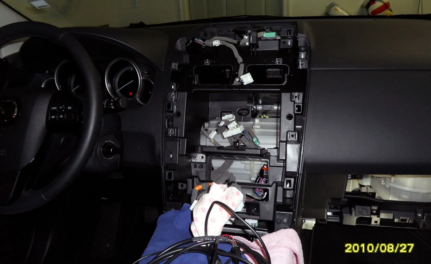

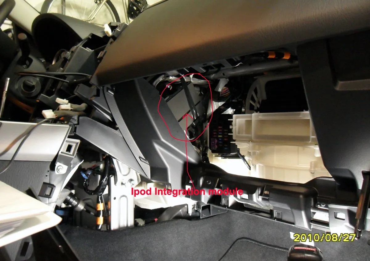

Spent a few hours doing it on Fri night. The outcome is very satisfactory. I chose to route the ipod cable through the front cubbie (the one below the climate controls). The instructions from Mazda is spot on, take your time and no damage will be done. I do find that the finish is prong to scratch, as I found out the hard way....

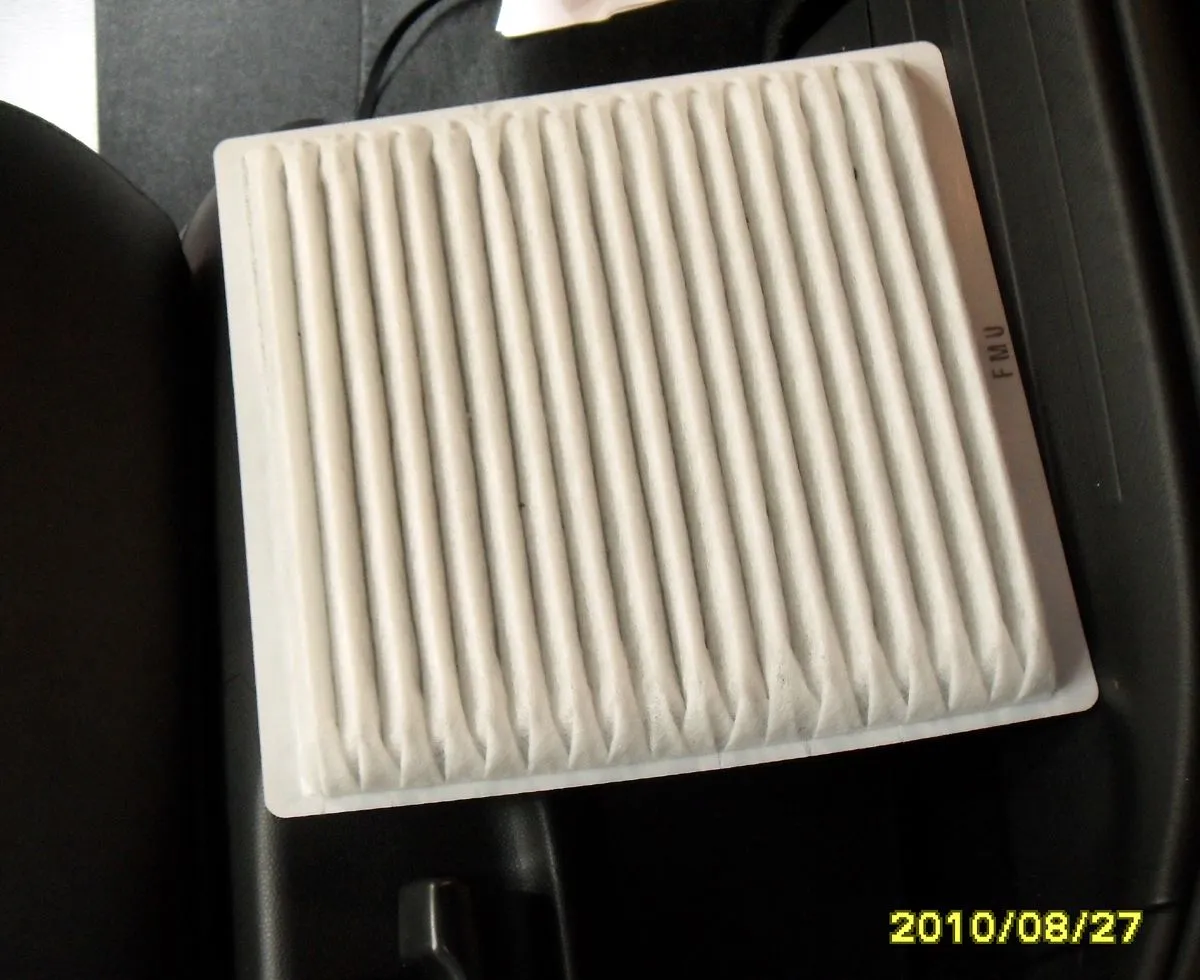

Here are some pictures of the center console gutted open. Also, I found the cabin filter is one of the cheesiest one I have seen, among other cabin filters I have used in other cars (mostly germans), Ford really is skimping on material.

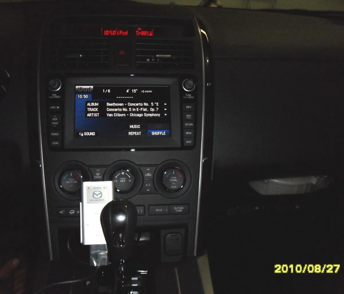

Once connected, the ipod is controlled by the head unit, with song title displayed, artist, etc. The sound is definitely better than using the aux jack. I can connect my iphone and it plays songs from my iphone, plus charging the iphone/ipod.
