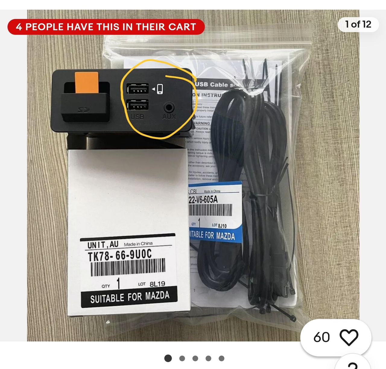

I've just returned to driving a Mazda after several years in the wilderness. I've got a 2019 Mazda6 2019 2.0 petrol Sport Nav+ with firmware version 70.00.335 EU N. Do I need to buy a kit to get Apple Carplay or is the hardware already in the centre console by the armrest?

Do you have this symbol on your hub? If no, likely not equipped.

Thanks for the swift reply. No, my module doesn’t show that detail … looks like I’ll need to cough up some more cash!

Just to let the forum know, I bought a Chinese USB module from Amazon, priced at 56 GBP. Did a partial install and confirmed that the device did not work. Returned with full refund but it’s a lesson others don’t need to repeat. Now waiting for a Mazda OEM part from a genuine trader in Australia … fingers crossed that I’ll get CarPlay this time.
