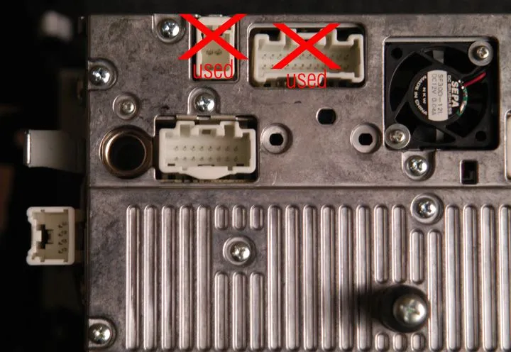

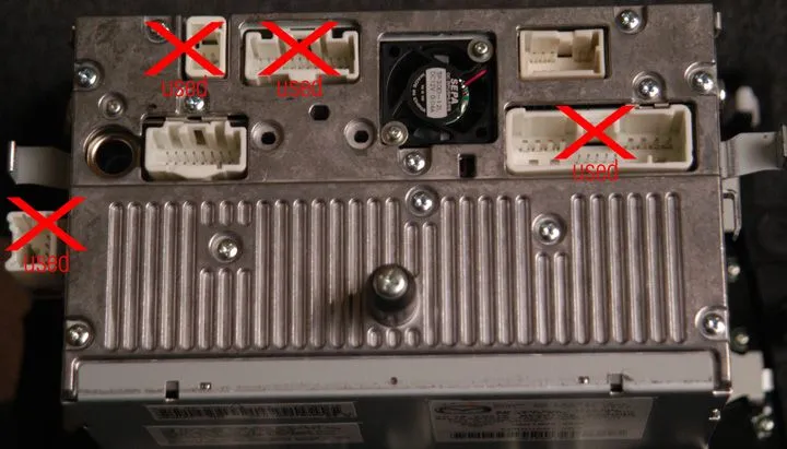

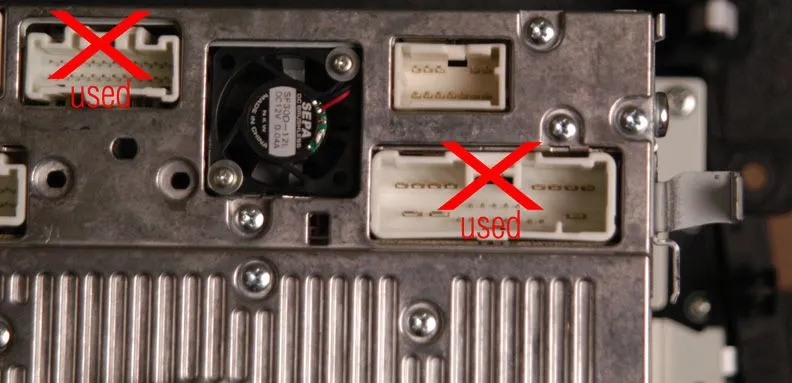

Pics of inputs on back of factory Navigation
I just pulled the stereo out and took some pics of the inputs on the back. Here they are. It looks like the input next to the AM/FM antenna port matches the connector for RPM's iPod Integration.
http://www.therpmstore.com/product_info.php?products_id=142
Any thoughts on this? Has anyone with the factory Nav system bought the RPM product and tried to install it?

Great pics......thanks for sharing
although the RPM adaptor looks like it could fit, the site page itself clearly states that it is not compatable with factory NAV systems. Still cant figure out why BOSE would design a system without compatability in this day and age.

Just installed the RPM Ipod Integration adapter and it didn't work! SUCKS ASS!!! It charged the iPod but when I pressed the SAT button nothing happened. I tried everything. Back to the drawing board I guess. The instructions that were included gave examples of the displaying of iPod info. It was limited just like Mazda's iPod adapter. LAME!!! Guess it doesn't matter anyways since it doesn't work.
