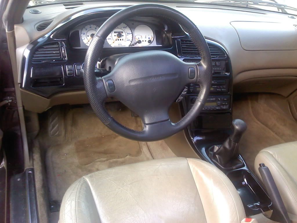

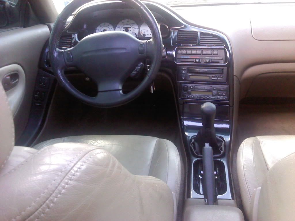

Older Thread but here is what i have done to mine so far , reason for change -
Few minor changes to get rid of wood grain -
Thanks , I appreciate it .I found a different shift knob with a bit of weight to it but that's about all I have done since these pics.

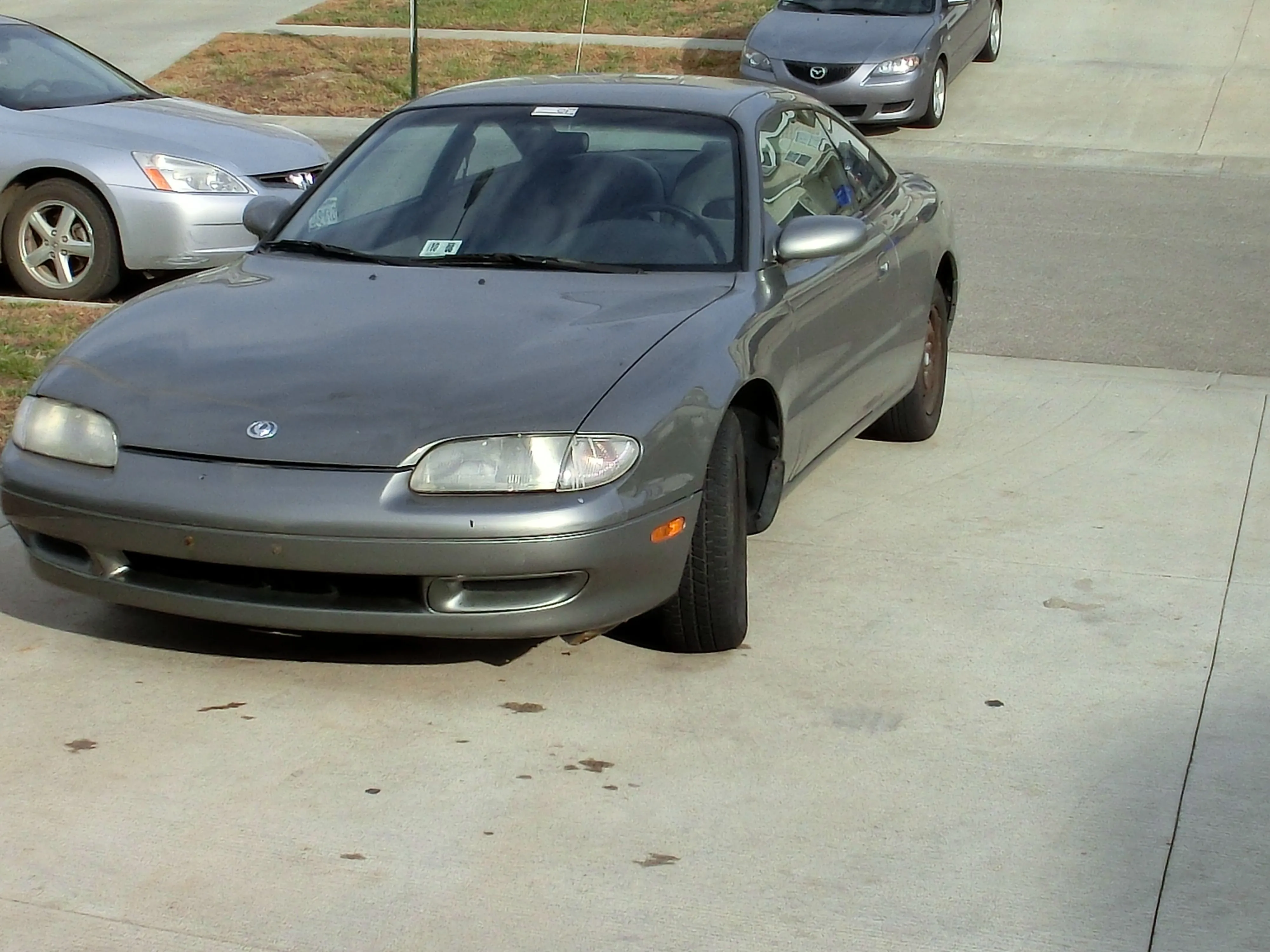

better than me mine is bone stock inside still, after i get it running without i stall when its warm ill turn my attention to the inside, im going with a gutted look haha and a huge 15 in the back!

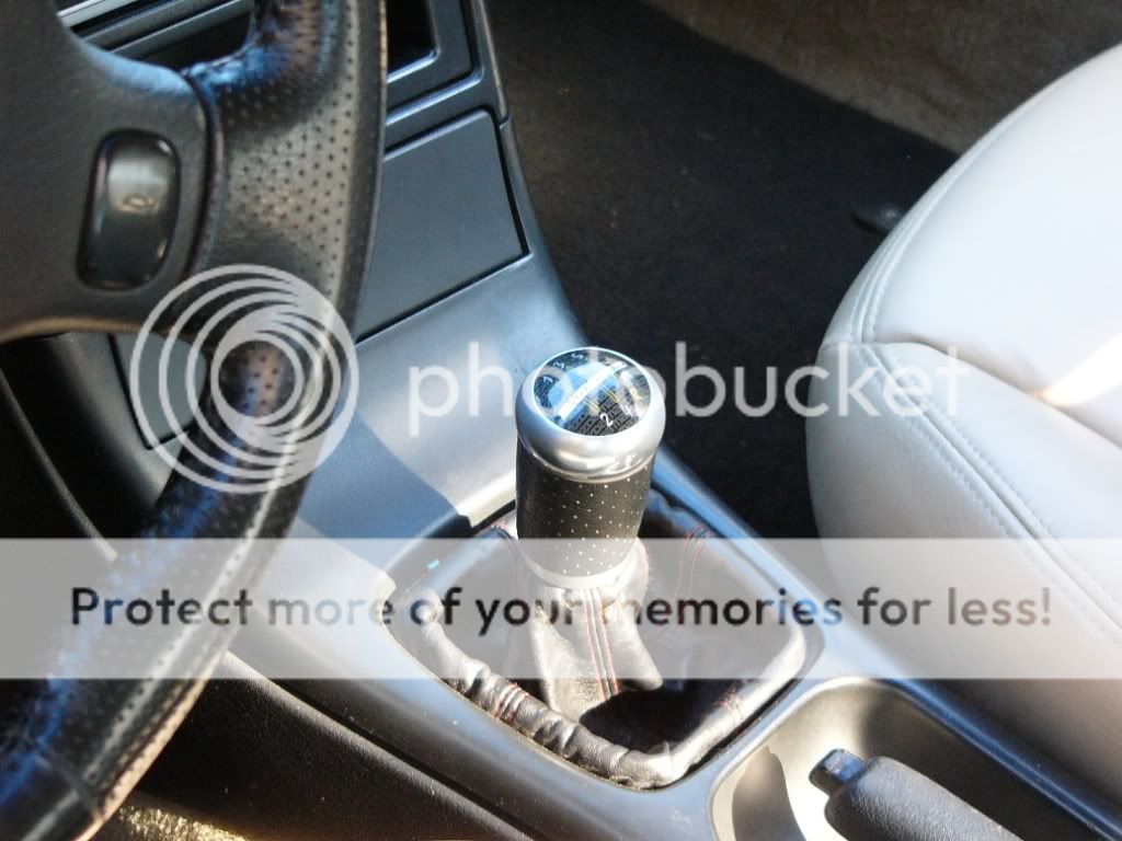

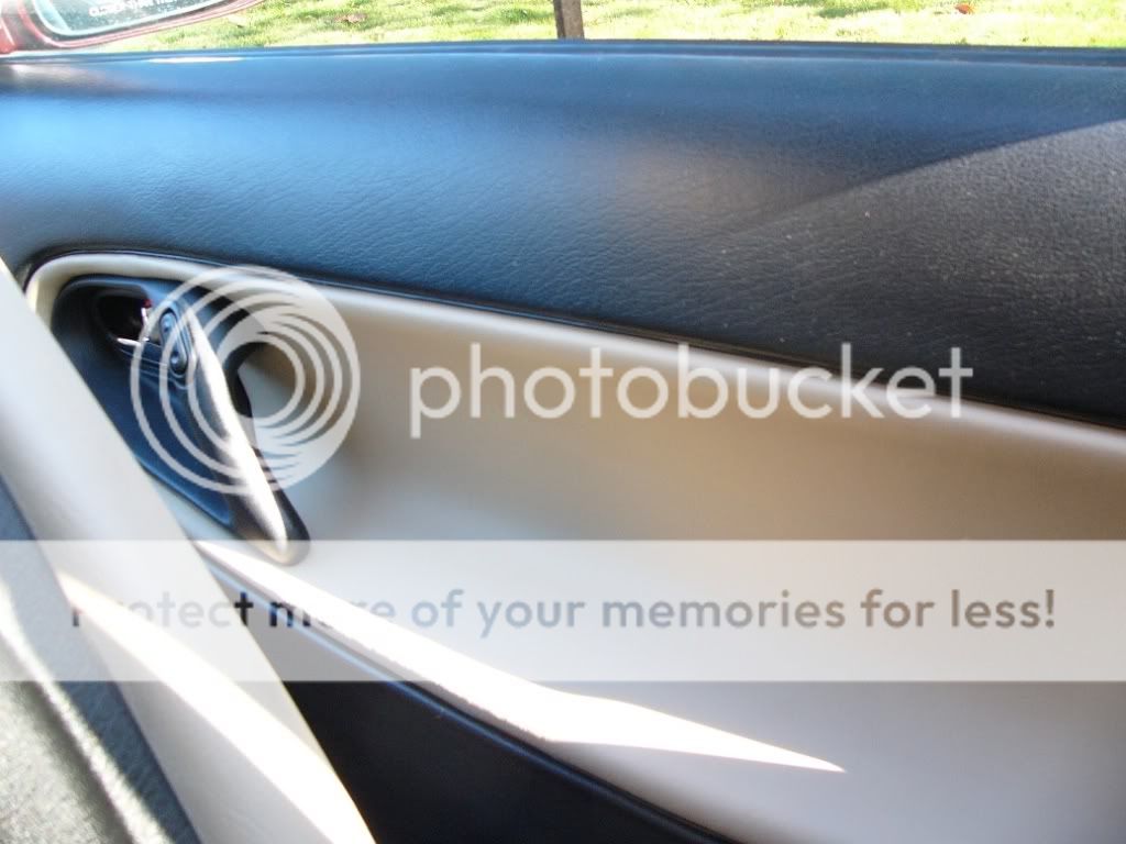

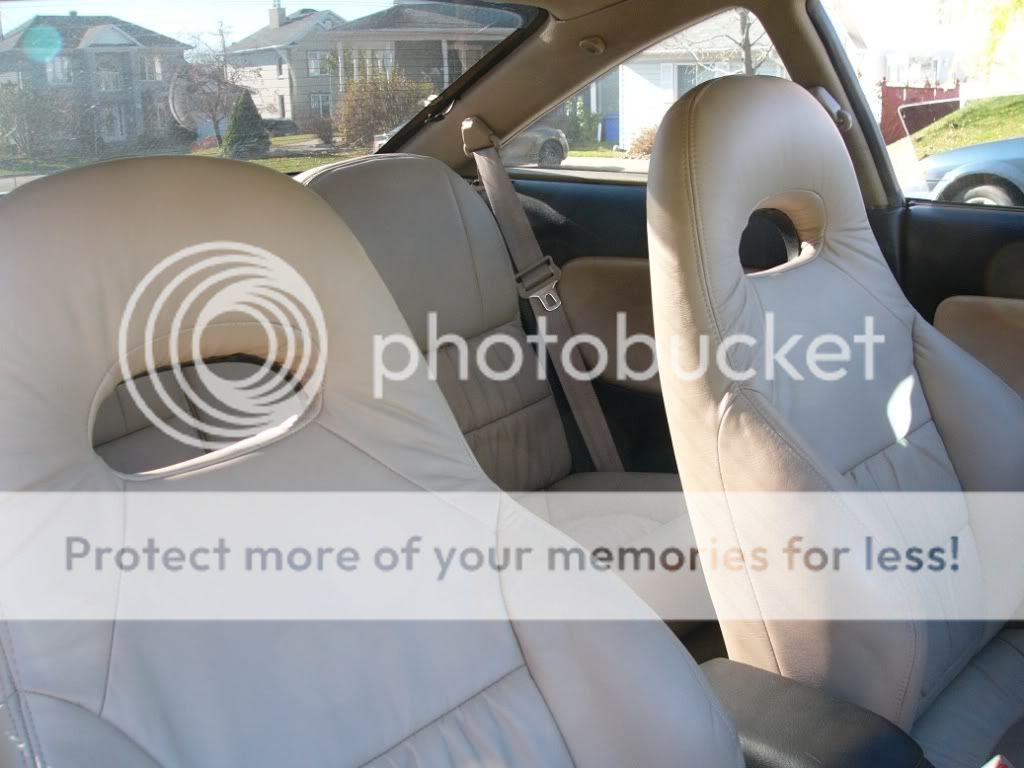

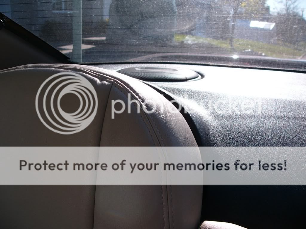

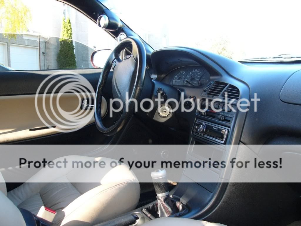

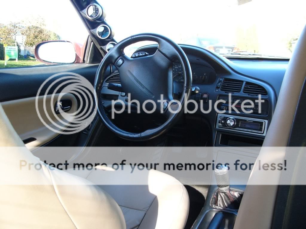

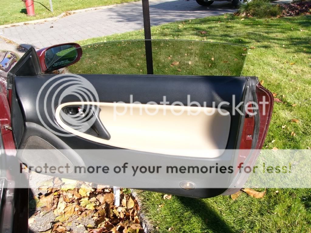

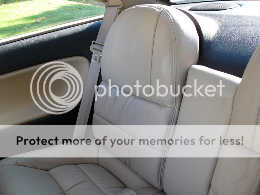

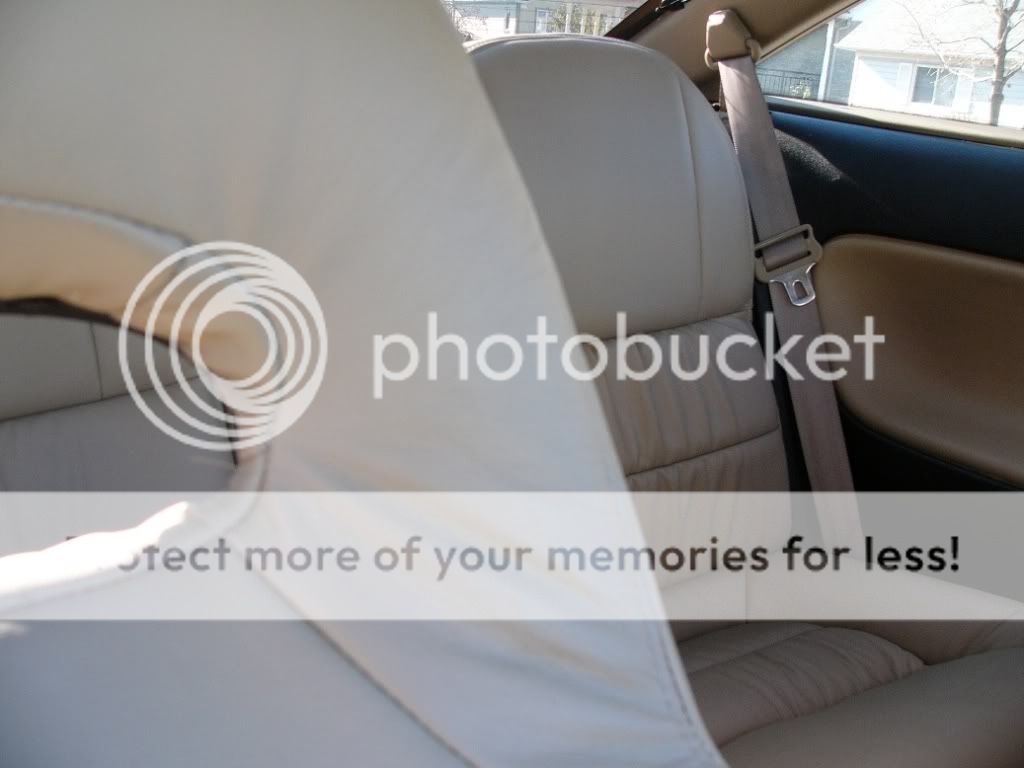

finished this before storing the car for winter...It was a first time for me at anything related to reupholstery. I bought some katzkin seat covers and then I reupholstered my door panels. The seats...not that hard, just time consuming. but man, the panels took me forever and has been very hard to get it right! But anyway, let me know what you think:
http://i268.photobucket.com/albums/jj30/poissonn/P1190045.jpg
http://i268.photobucket.com/albums/jj30/poissonn/P1190043.jpg
http://i268.photobucket.com/albums/jj30/poissonn/P1190040.jpg
Not bad for a first timer if you ask me!
Very nice!! is that a RR-racing shifter boot? do you have any pics of the build up of the interior, like from start to finish i want to do mine as well but dont know where to begin, i think the seats will be harder for me, i have done door panels before and they do kinda suck, maybe add a material list for the rest of us,
very nice interior very clean.
I don't know what's the shift boot brand...bought it used on the forums! And unfortunately I do not have any pics of the build up...never thought it would have interested anyone...! The seats are the easiest part if you ask me. You can do it in a day, at least with katzkin seat covers. Door panels are almost impossible to get perfect, they are way too curvy. there is some flaws on mine but they are very small. All you need is time, hog rings with the right tool to install them, some vinyl material for the doors, a heat gun, a good reupholstery glue, some kind of "paddle" to get the vinyl to sit right in the door panel grooves and a sharp x-acto. You must be very careful heating the vinyl as it is very easy to overheat it and then it melts...
cool thanks for the tips, i would love to see post like that, there are to many people who like cars and dont know how to do anything on here, thats one of the reasons after i asked about a body kit i decided to do my own thread. i will try ur technique for the interior, ? though what are hog rings
the shifter knob is from an 03.5 MSP, the boot looks to be from a msm if i remember correctly for boot

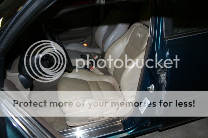

here's my 626. but interior wise its pretty much a mx6.
my baby is my mazda6. and this 626 is the beater. but my g/f does drive it a bit, and i wanted it as nice as possible.
here's what i can remember doing. but i probably forgot alot also.
Rare OEM M-Edition mx6 leather front seats
Rare OEM Stainless "626" door sills
stainless gauge cluster rings
leather E brake boot
OEM leather/chrome mazda6 shift knob
full red LED gauge cluster bulb replacement
OEM 3rd gen protege cubby hole under radio
touchscreen flip out dvd player
OEM 3rd gen interior chrome handles (direct replacement for 626 color matched plastic ones)
front and rear infinity speakers
alpine 4 channel 500 watt amp running running interior speakers
kenwood 800 watt amp running a single cerwin vega 10in sub.
