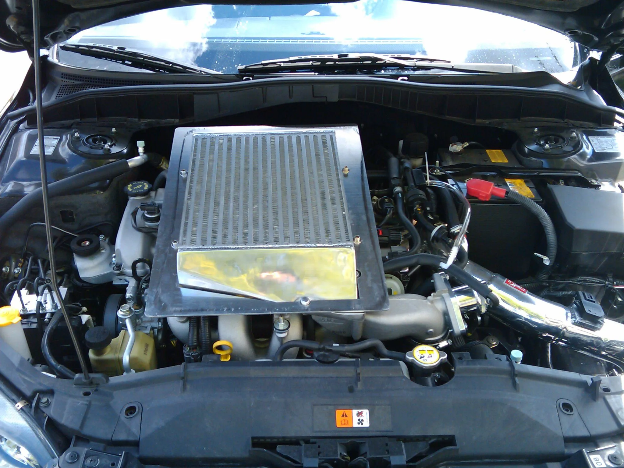

Coyfish, can you take a pic of the SU TMIC in your engine bay?
Yeah Ill post one tonight or tommorow for sure.

oh crap i completely forgot about those pics! Ill have a pick up tommorow afternoon around 1pm when I get out of class.
There ya go guys! I have a few more pics from side angles if you want me to show just let me know.

I'm pretty sure that's a natural finish.
Coyfish - were there any instal problems? Some of the people that installed their ETS had issues with matching up some of the rear IC piping.
Yeah thats the natural finish. The install was pretty painless. Hardest part was taking the stock IC out because the stock hoses were on their good. The rear piping is kinked slightly though. The problem is not with the design but the fact that its just bigger which is why both the ETS and SU have the problem. Its really not that big of a deal. The hose just has a little kink that bends the hose slightly. My girlfriends birthday is today and i have class untill 6 so i don't think ill have time but tommorow ill post the rest of the pics / see if I can take a picture of the little kink.
The install took me like 10 minutes but I did it at my parents house so my dad helped get the tubing on the IC as I held it. Makes the job a bit easier.
