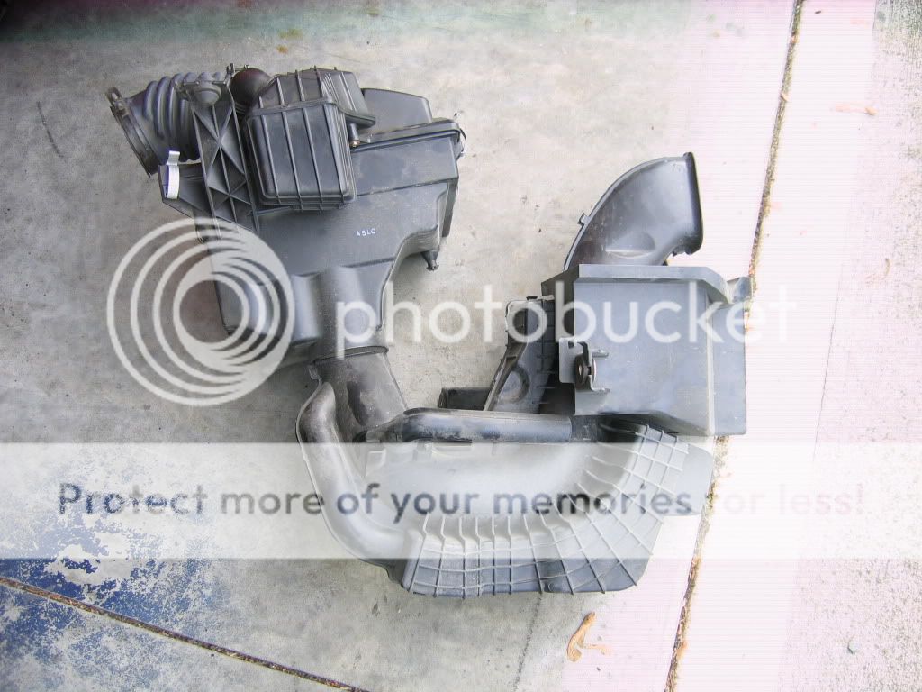

In case anyone is questioning why replacing the factory intake on the Mazda3 2.3L engine makes such a big difference, just take a gander at what the air has to fight through before it reaches your intake manifold.
Not only is it a hell of a restriction (obviously to reduce noise) but the entire contraption weighs over 10 lbs.
The second photo shows it next to my MX-5 just for some perspective of how massive it is.
