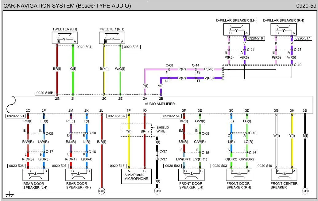

So I ordered a Rockford Fosgate P300-10 and an Audio Control LC2i to do this install. As recommended in other posts I am planning on tapping (posi taps) the rear speakers (to get full range signal) into the LOC and then in to the sub.
Anybody knows the speaker wire size in the factory Bose? I assume it is 16-18 awg.
If anybody has any suggestions or recommendations I am all ears. I'll post pics of the install ....thanks
The "rear" speakers? Do you mean the rear doors or the far rear (D-pillar)? If you are referring to the D-pillar speakers, they are mono - so you'd only have to tap one. (The rear doors are stereo, but I don't know if they are full range or not.)
Yes..i meant the rear door speakers...I see that many are also replacing the factory dear door Bose speakers with JBL 6.5" (2ohms) coaxials....it seems to work since the factory bose are 3.7ohms....any experience with that?

I have the RF P300-12, which is the same amp but with a bigger box and speaker. I had VERY poor results. The subwoofer's output is inaccurate with the rear doors' Bose speaker signals and lacking output. Pulling signal from the front lo-mid range was even worse with severe muddiness. Gain and crossover tuning did not help. The worst part was the Bose's high frequencies sounded very harsh, thin, and almost shrill whenever the amp pulled signal from the speakers. With the signals unattached to the amp, it sounded normal again.

From what I read, you can tap the signals between the headunit and Bose processor/amp. Unfortunately that signal is very weak. Also the diagrams do not label the wires in the harness, so you would have to discover the signal wires yourself.
Apparently the Bose processor isn't entirely digital and still uses analog signals for the speakers. It does heavily EQ the signals to the speakers, so the output signal from the Bose amp isn't the best source to begin with... Give it up to Bose for processing and EQing everything, making things more complicated.
