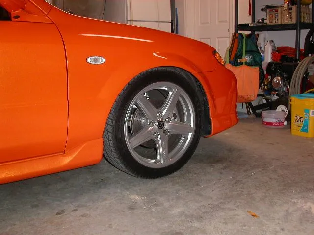

Oh, and attached is a pic showing the drop in the front, but the overall effect is much greater when standing farther back from the car. It's crazy low compared to stock. I can't get one finger in there unless it's angled up. I also found out that my rear driver's side lip has been rolled, but my rear pass. side has not. It's amazing to me that so much weird stuff was done to a car that I bought with 8k miles on it. The previous owner evidently did screw around with the suspension, which would explain my missing rear bump stops. I'm going to roll the other lip before putting on the rear Illumina and Goldline combo. I'm already worried that the Illumina's lower spring perch and the drop from the springs will combine to have the rear tucked like a BMW.

that does look good. If the jury comes back good after getting an alignment, i think i'm getting me some goldlines!!!
