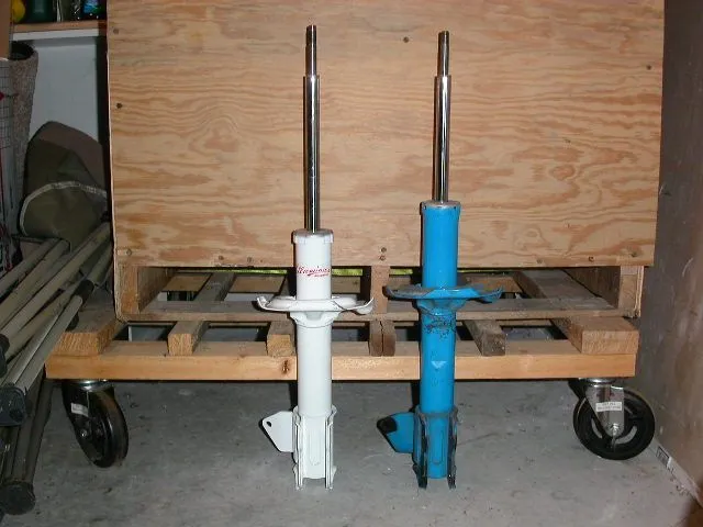

I did a bunch of research before making this choice and am expecting to be happy. One thing I'm about to be able to determine for sure is the difference in the perch height of the stock rear struts vs. the Illuminas. IIRC, the Illuminas rear perch is supposed to be lower. The fronts are pretty much identical to the HP's. I'll put up some pics of each side-by-side shortly.

Right, I was thinking that the illuminas would balance out the drop better than the stock msp tokico's. With my tein s-tech springs the rear actually sits higher than when i was stock which is annoying. Again, good luck with the install bro

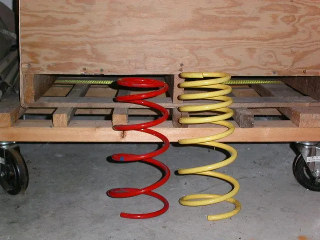

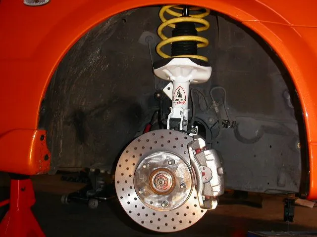

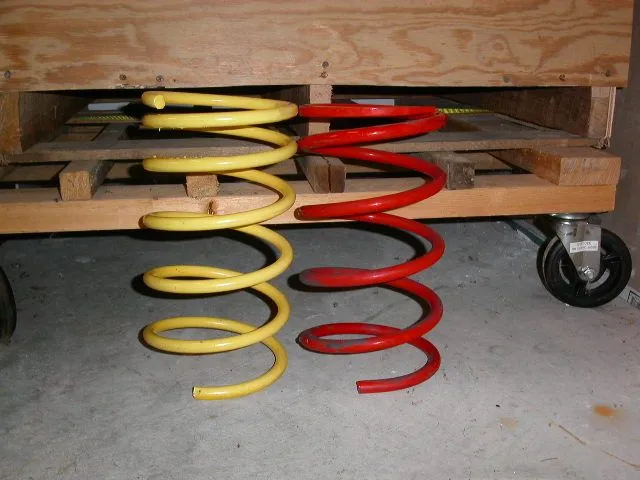

Attached are some pics of rear Tokico HP vs. the Illumina as well as the original RB MSP springs vs. the Goldlines, both front and rear. I know there are pics up somewhere of the struts, but figured it couldn't hurt to put 'em here too. The front struts are essentially identical in dimensions, unlike the rears.

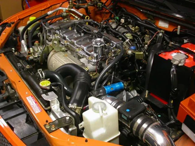

Notice how the front springs are the same height & the rear Goldlines are actually taller than the RB's? If they're slightly stiffer, how is this going to lower the car, lol? One pic shows a complete strut with the new drilled rotors. There's also one of my engine bay showing off my polished intake piping & valve cover, heh. Next will be the heatshield and then I'll have to finish polishing the tranny case. Rainy day stuff.

well since they're progressive im guessing they lower because the first few inches of compression is actually softer than the stock RB. as it gets settled down to its normal height it should feel the same as stock but with less roll because as it gets compressed more it gets stiffer?
just a guess on why the two springs are almost same height. at least for the fronts....
Yeah, I figured as much myself. Even though the fronts are both linear (IIRC), the Goldline has one more turn in it. Check out how many more the rear has.
