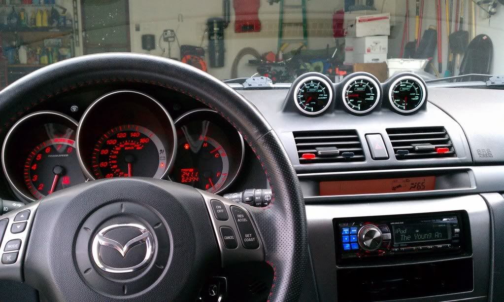

here is a test fitment pic during my installation, just to see how well the single din bezel snaps in...the gauge illumination is literally identical to the factory color, so i'll try to get a night pic when i get a chance. I played around with the bezel, font, light up color, needle color, needle design, and a few other things...for no charge over the standard gauge price...very high quality sensors and wiring included also...not trying to sound like a commercial, but i've been happy with these so far.
https://docs.google.com/file/d/0B9wG_iZEqPQNZGJKOFo2RFdZeGc/edit?usp=sharing
https://docs.google.com/file/d/0B9wG_iZEqPQNYlNoN1FyRFhMbW8/edit?usp=sharing
Is it just the camera angle, or is the left gauge rotated very slightly counterclockwise from vertical? Looks nice though.

That was just a test fitting before I wired them. None of them were straight, and for final fitment I rearranged the outer gauges. I finished the work with very pour lighting in the rain, so haven't taken finished pics yet.
