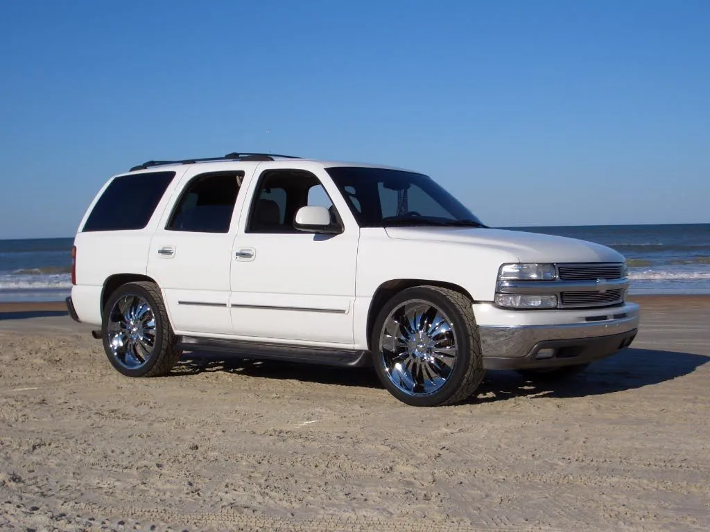

it's actually $110 for the rewinding and $100 for the rebuild. more power is definately a good thing. after tweaking we are still getting dimming lights. Just didn't notice before cuz it was daytime. This alternator upgrade will fix that totally and should be good for whatever we can dream up next. tahoe is sittin 3" lower on 24's. got escalade rear glass, and rear vents as well as door handles. Got roof rails and side steps on the way. heres a pic of her sittin on the beach in orlando.
