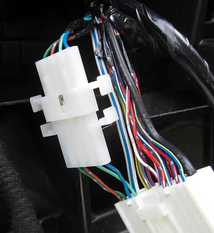

As someone did elsewhere here I installed Molex connectors in the front speaker wires so I could choose to reconnect the original speakers if I so desired. This meant that I didn't need to do any soldering, but you have to be very careful and deliberate in your connections so everything lines up properly when the connectors are mated.

The 1st picture shows the Molex connectors patched into the front speaker wires on the back of the large plug that goes into the passenger side of the HU

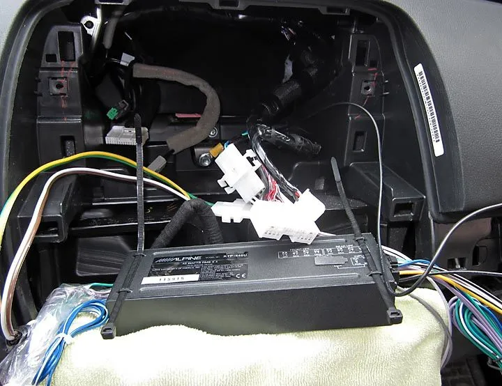

This next picture shows the KTP unit with the provided cable ties attached to it and the patched Molex connectors attached to the KTP wiring and plugged into connectors on the speaker wires from the picture above. Note the ground wire (with the yellow collar) temporarily attached to the HU bolt in the center of the picture - this was just for testing. All unused wires on the KTP plugs (for the rear speakers, for instance) were wrapped up with twist ties to keep them out of the way. I didn't want to cut them in case I might want to use them in the future...

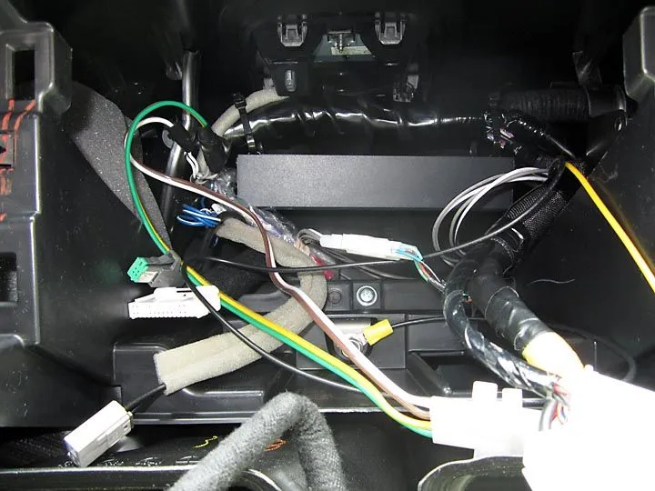

I attached the KTP-445U amp using the cable ties and hanging it from a large wire loom along the top of the dash just below the windshield, directly behind the center dash speaker grill (the clips of which you can see in the top center of this next picture). The yellow wire on the right is the power input that you'll see in the 4th picture. The black ground wire with the yellow collar will be re-connected on the bolt in this picture after the HU is put back in - this bolt used to hold it in the dash.

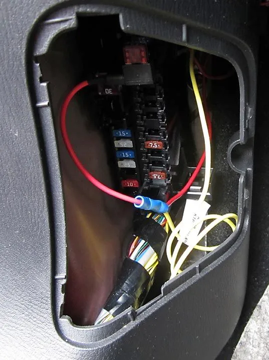

Here is the Add-a-Fuse I added in the fusebox by the drivers left leg. The red wire goes to an accessory outlet I added for my GPS and the yellow is connected to the yellow power-in wire on the KTP unit. The white rectangular thing attached to the wire is a label in case someone other than me wonders what it is for.
