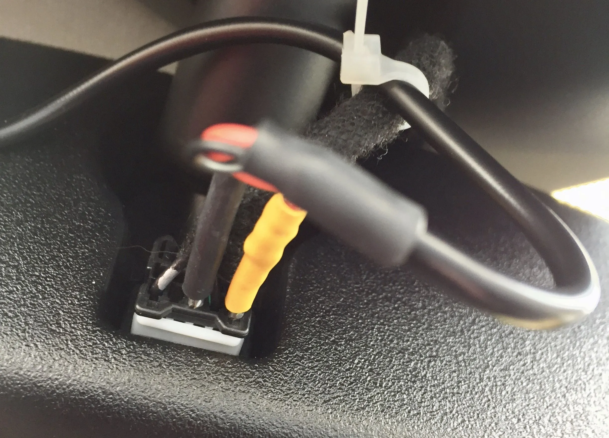

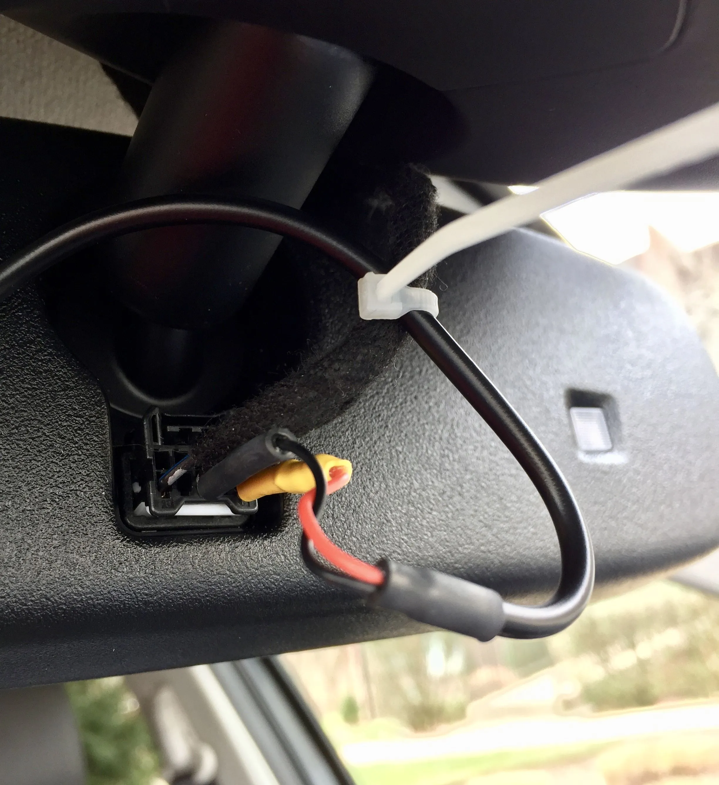

Hello
Can you kindly share few pics showing the wiring. Mine is connected to the always on Cigarette lighter port and its a pain to pull the cable every-time. Want to connect to a switched connection the same way you have done.
Pictures attached :)
This is a 2016.5.
This is a 2016.5.
Thanks a lot Katmar. The power tapped from behind the Rearview mirror is 5V ?
From the pictures its look easy to connect to the Rearview rather than to the Fuse box Mine is a 2016 with Teck package.

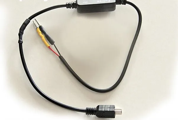

just to confirm, this is the one you bought right ?
attachment.php
http://invisicord.com/osc2/catalog/product_info.php?products_id=58
~ $24 + $4.95 fuse .....
