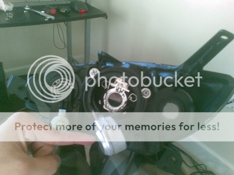

i'm about to bake the headlights. i remove that plastic bracket and the high beam bulb. is that it? should i remove something else like the ballast and the low beam bulb? thanks.
quick question... (to all of u)
I removed everything including all bulbs and ballasts. However I did not bake them, I used a heat gun.
cool i have a heat gun. i see a screw in the low beam, just unscrew that and pull it out?
Factory HIDs or not? Everything just popped out with the OEM HIDs so I don't know what screw you are referring to.
nvm, i figured the ballast part out. is that it coz i want to bake it now lol
also should i take this part that i'm pointing to?
That you can leave on. You wouldn't be able to take it apart without opening the headlight anyways. Looks like you are ready to go.
If you are doing the heat gun method it takes a little longer.
Let us know how it goes - and post if you have any further questions. We can walk you through it, but Element has been doing a superb job thus far :)

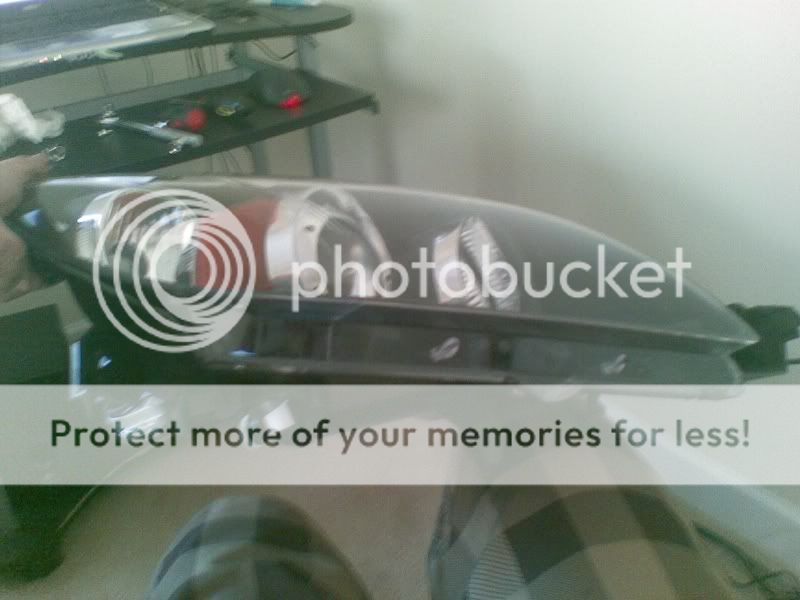

thanks. well i took a looong break but i'm ready to go again. few concerns putting these back together:
- i put 6 washers on each headlight. when i put the assembly (the projector assembly) back, how far should i go? i was messing with the other light and now i can't compare how tight should i put it in
- i didn't push that white pin (for the adjuster) back. when i bypassed that and just pulled out the projector assembly, the pin is attached to it. am i fcked?
- i purchased the led strips from TRS. should i glue it first before resealing everything or bake everything and before i close the headlight shut, then i glue that in (will be using some generic super glue)?

1) I marked my screws so I know where to put them back to for alignment purposes. Not sure how far back it should go to be honest. Sorry. I would suggest just adjusting it until it is snug, but not hitting the chrome clips.
2) You should be able to still clip everything back together.

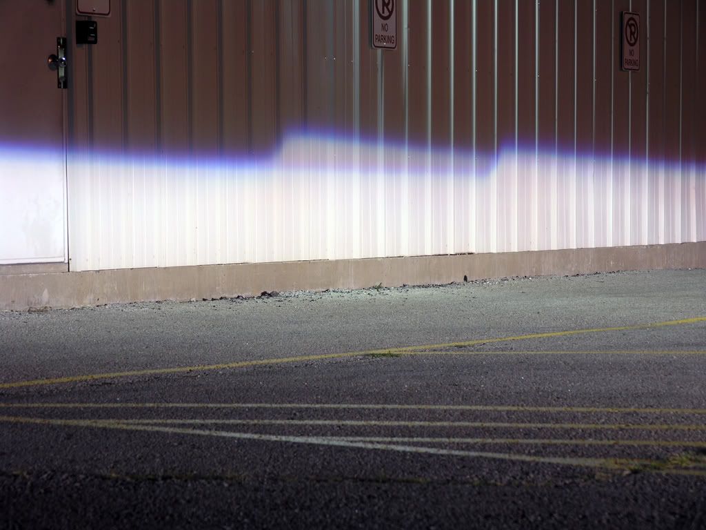

overall, i'm not really satisfied with the result *my fault*. the cutoff is similar to this one: CLICK. however, mine is a bit "blurry" at the center. it has some sort of glare but it is colored. some concerns:
- the beams won't adjust using the switch inside the car
- the cutoff is not as crisp as everyone else. some areas are not smooth.
- the driver side seems to get more light than the passenger side. although not by much.
i'll take some pics once i find my camera. everything is back in place now and my fingers hurt lol
nope. does it absolutely help? coz i don't wanna bake it all over again to find out it didn't work.
It it worked for me:
Although that is 6ft away. Still Good. I think the combination of not blackin it out and using too many washers is why your cutoff is suffering
