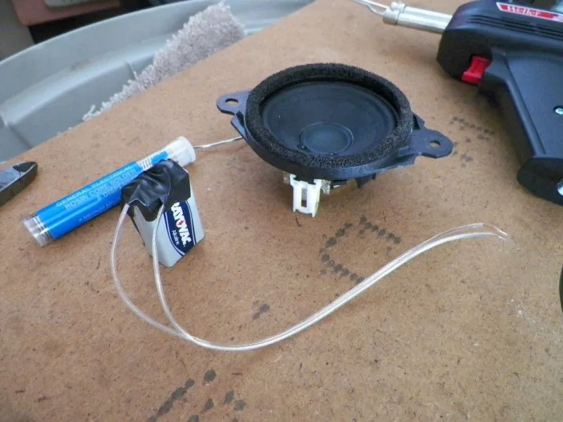

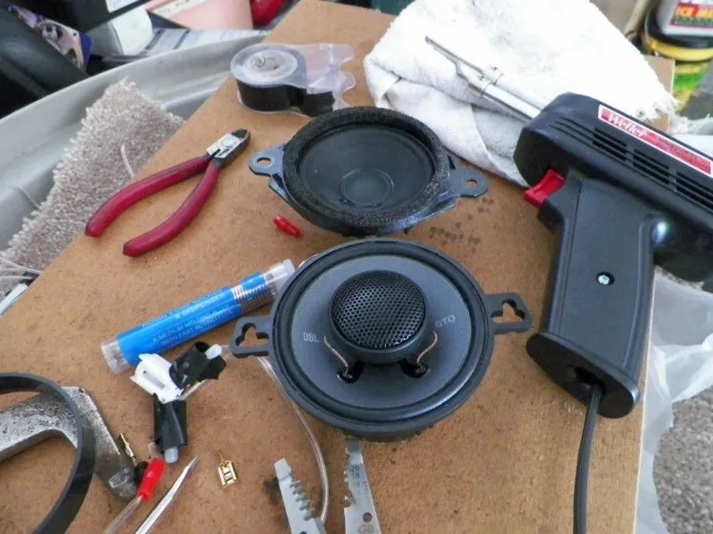

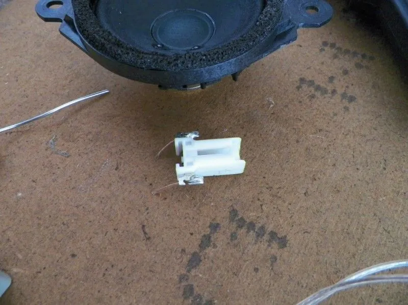

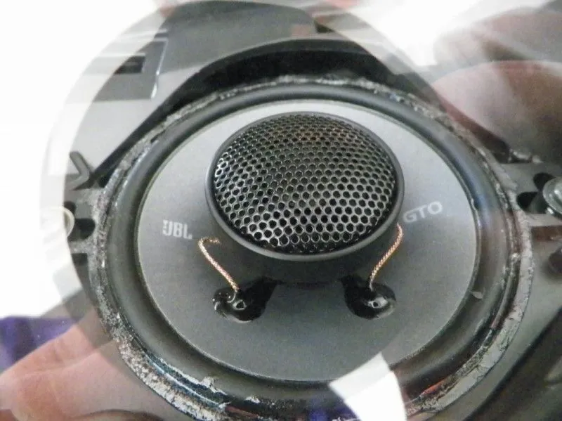

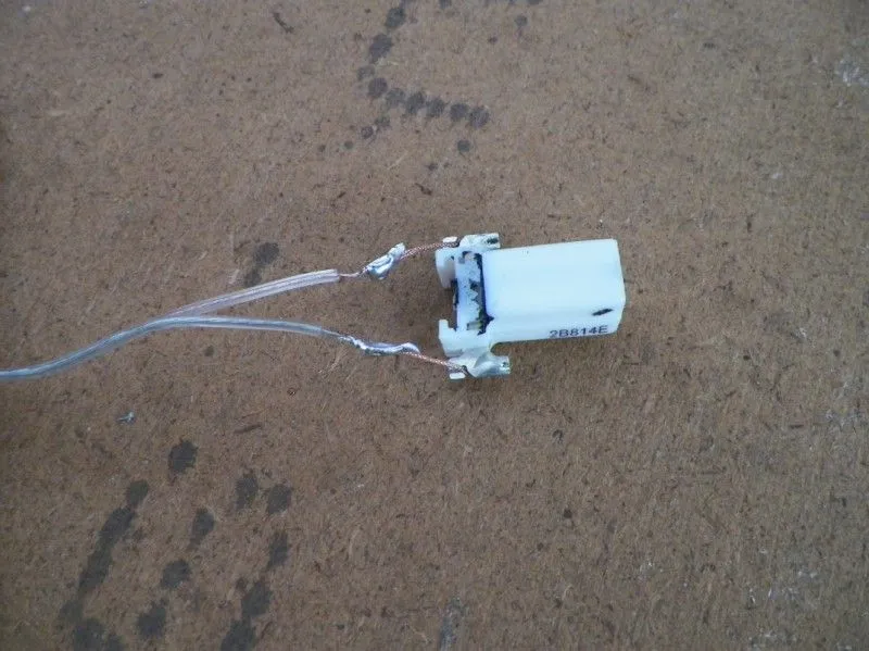

Bose should be ashamed of themselves for the terrible speakers they put in this vehicle. I installed 3.5" JBL's in the front dash. The old wiring was not marked so I checked the polarity and found that the portion of the white plug to the old Bose speakers with the black writing is the negative side. I took the white plug off the Bose speakers and soldered the connections so I could use it with the new speakers. This sounds so much better.

really simple...pry up the speaker covers using some type of mar proof tool..the two screws can be unscrewed using a small socket with a Phillips head in the socket...the white plug pry's off the old speakers, solder the old speaker wire to the new speaker connectors. Make sure there is enough clearance for the
new speakers so the speaker cover fits.

What speakers are you putting in? GTO329? Apparently they fit so no need to worry. If other type of speaker - maybe you can remove the tweeter grill to give more height clearance - otherwise you need a different speaker.
The tweeters on those GTO speakers look to stick out as much (or more) as any other speaker.

There will be height measurements for any speaker...the gto 329's fit perfectly and if you are putting in Polk speakers they most likely will fit. Mine were 2 1\16" or 52 mm from magnet to the top of the tweeter. This allowed the grill to be easily placed. Good luck.
Thanks for the information. Do you know what the difference is between the 329s and the 328s? From your pictures it almost looks like those you installed were the 328s with the wires on either side of the tweeter.
