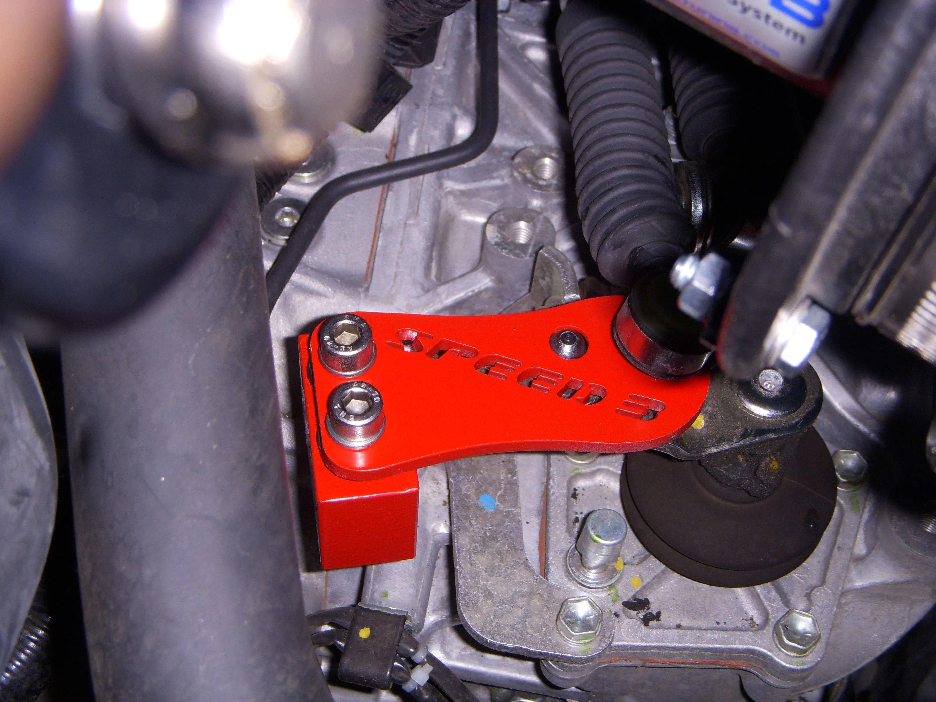

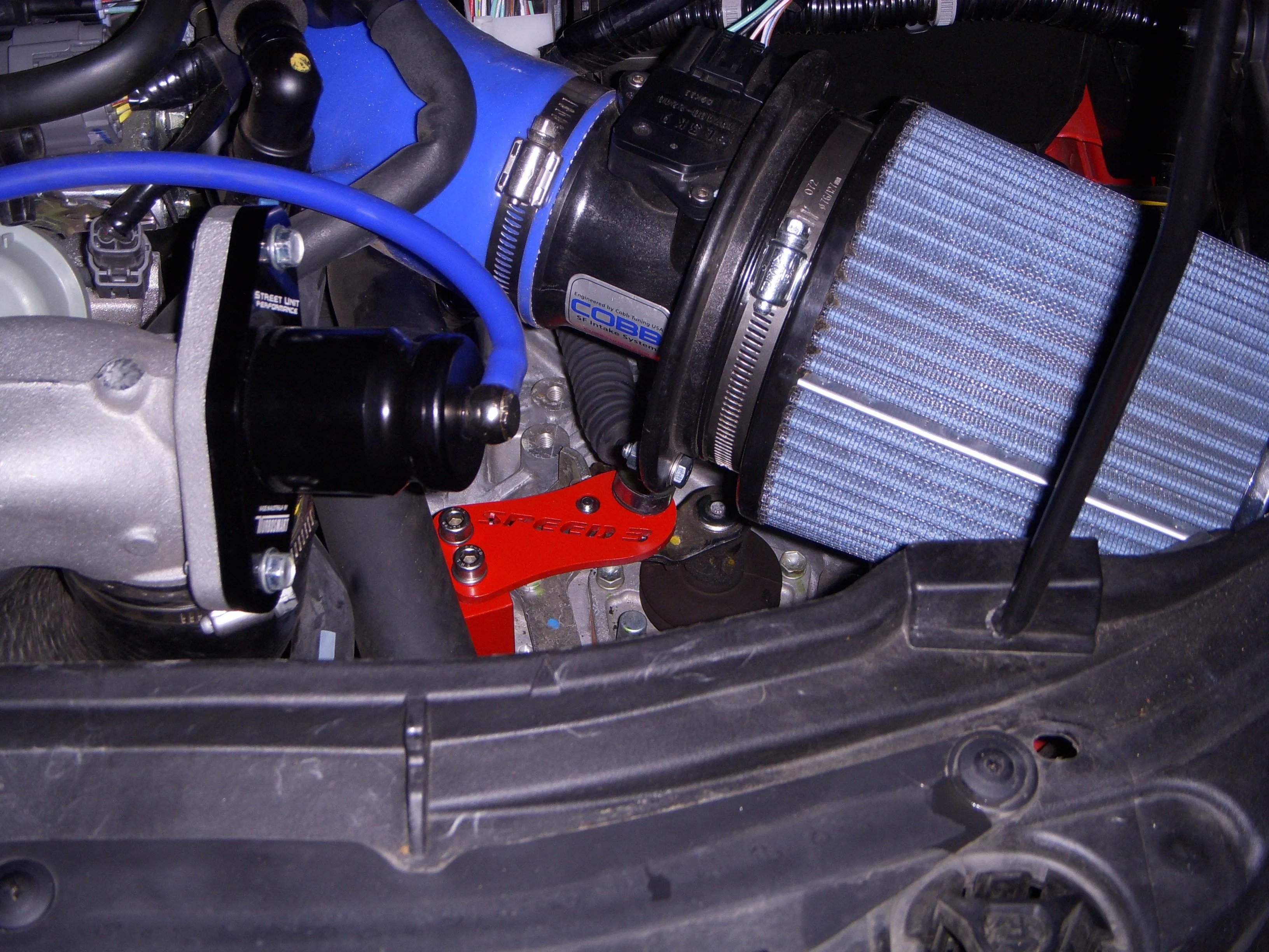

I know there have been a few reviews of this product but here's mine. I just finished installing the JBarone shift plate into my 08 Mazdaspeed3 and I am very happy with the results. I was worried at first because I have an aftermarket shift knob which is NOT weighted like the OEM knob.
Shift knob:
Install was fairly straight forward. Since I have a MS CAI I just removed the MAF section to give me a little more room to work. JBarone provides awesome instructions and everything is all laid out so even someone with limited experience working on cars could figure it out.
The product itself is a quality piece. I dropped it during install and the paint held up. The bolts, loctite, and lube is all provided. It looks quite nice in the engine bay and matches my custom True Red MS CAI.
I love driving with this shift plate. Shifts are much shorter and more crisp. I don't race or drag my car as it is just a daily driver for me, and this is going to definitely make shifting more fun. Before the shifter felt sloppy and loose, but now it feels rock solid and more reassuring that it is in gear. I like the fact that the stock height is retained while proving the shorter shifts.
Installed Pictures:
Any questions just ask.
