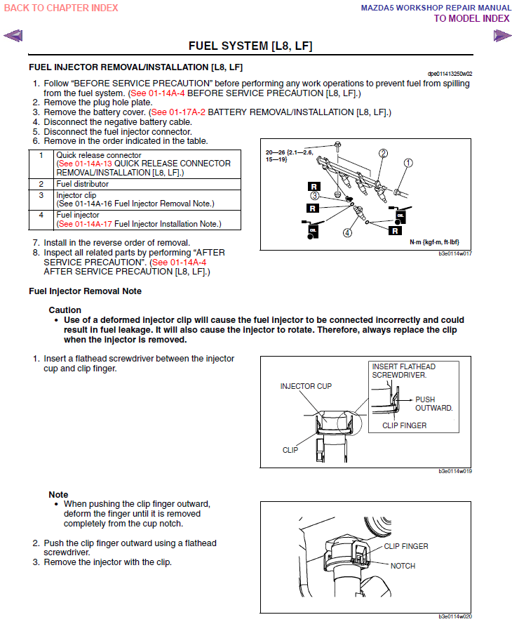

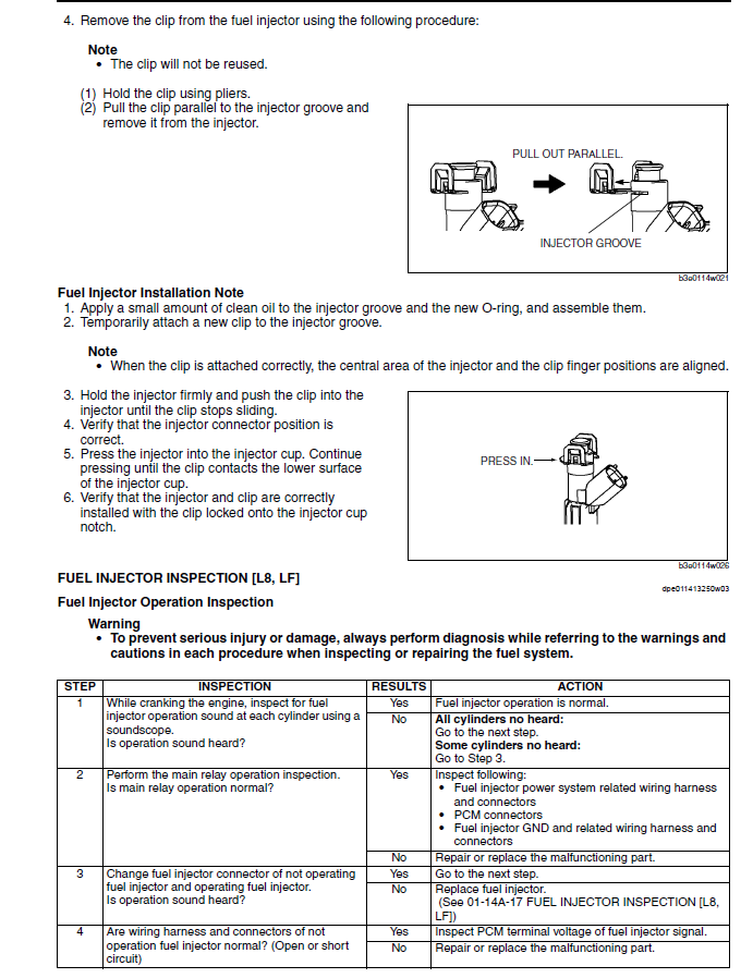

Hi. How do you remove the injectors in a 56plate 2ltr td sport. I have stripped down the rocker cover and fuel lines along with the clamps but cant move the injectors. Is there a specific tool or do they just pull out
I haven't looked at mine in quite a while- but there is usually a wire clip that surrounds the injector housing and keeps it in place. Look for a wire clip to remove, and be careful that you don't lose it!
