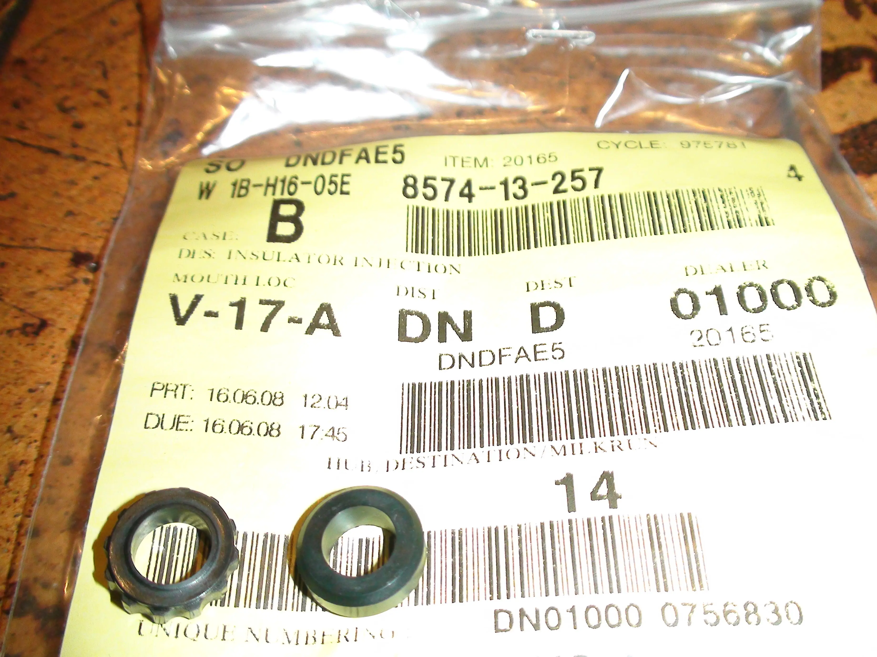

I found the below pictures in one of Rush's thread. The below pic is NOT the stock injector. However my question is... the yellow o-ring is that on the stock injectors? If so what part number is that? NONE of mine have that little o-ring on it. I even went down the to the local mazda dealer and all they said the injector had to make a seal was that black thing right before that yellow o-ring. Is that correct?

I have a set of Subaru Impreza WRX 440's ready to be installed (those are the same kind of injectors that is on the pic) and that I got on this forum without the isolator. I bought isolators from my local Mazda dealer and I got some rubber ones. I don't know if this is a revised part or something special about the european FS-7E/FS-7G engines though.
There are so many numbers on that sticker, but if I read it correctly the part# is 8574-13-257 - but there are some other number on there too, like W 1B-H16-05E
Since the injector in your picture is a Subaru injector you might get the injector isolator with the visible O-ring at your local Subaru dealer.

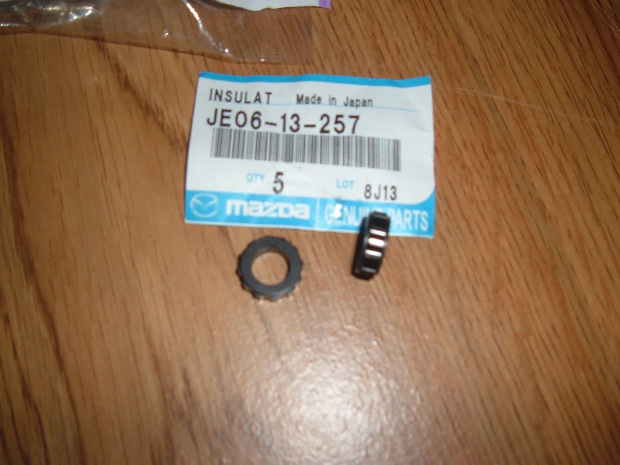

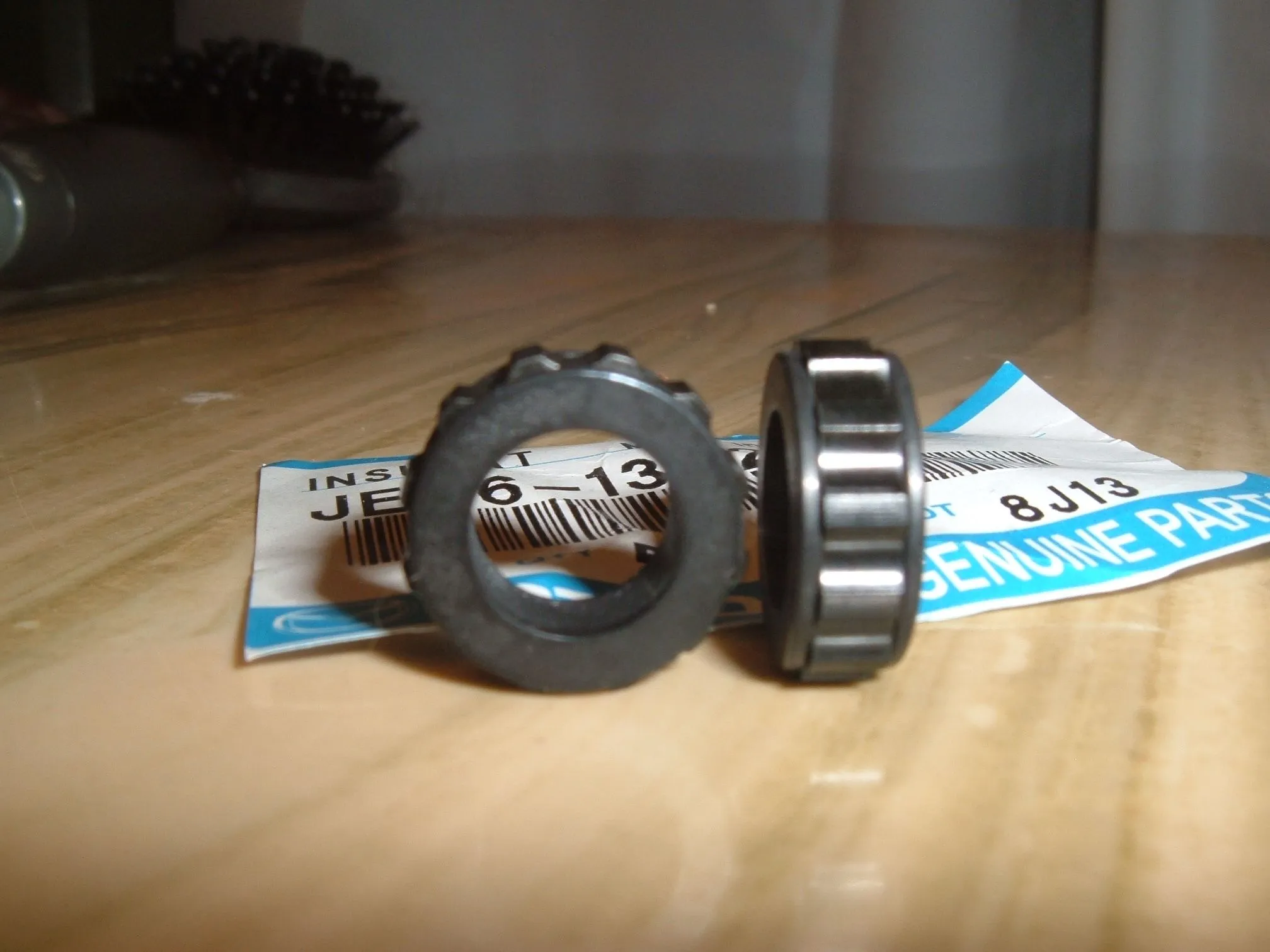

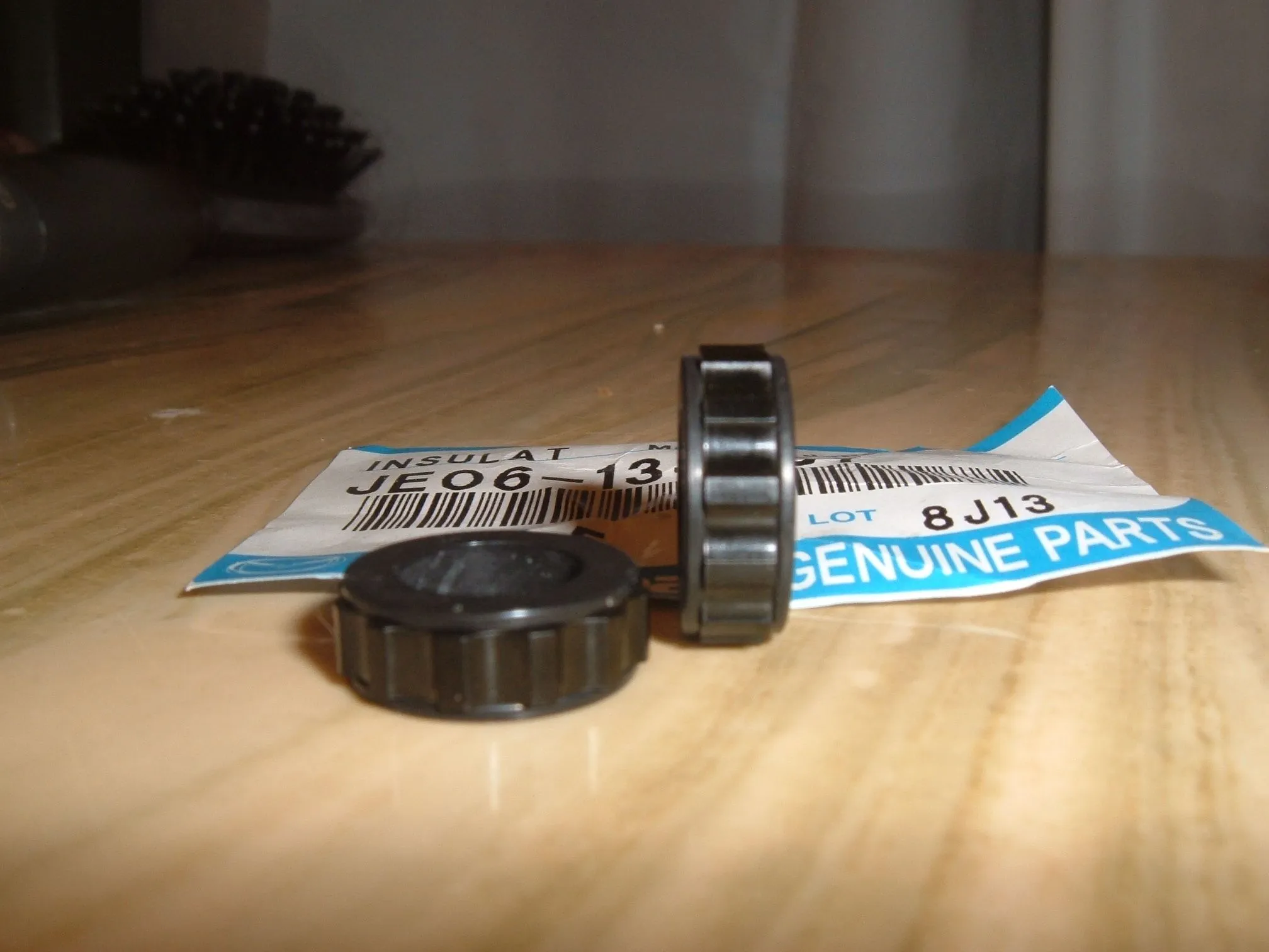

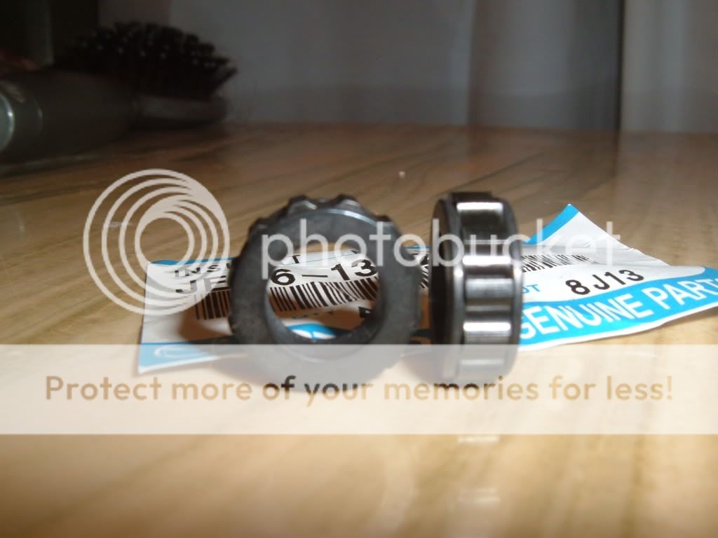

I purcahsed new injector insulator/o-rings yesterday from the dealer at the tune of 10 bucks a pop. They are slightly different then whats on my car. The biggest difference is the added rubber... no o-ring to say but I plan on install them tomorrow. Hopefully I don't rip the fuel rail o-rings.
Edit: isbre sent me a pic of the ones he picked up fromt he dealer and they are completely different then whats in my car and what I picked up to.
Isbre's stock on the left(looks just like my stocker) and his new revison on the right
and t hen onto the new revised part that I got from the mazda dealership yesterday. The new part has rubber on it so it should seal nicely once installed.
