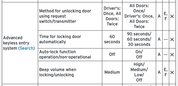

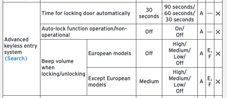

First image from the US, second from the UK.
Seems a double tap of the key works differently.
The second image (UK) seems to have truncated the "Method for unlocking doors using request switch/transmitter"
How is it different?
The UK version does not say anything other than what I copied, it certainly does not say "Method for unlocking doors using request switch/transmitter" or any other thing to mean that. I cannot find anything pertaining to 2 pushes of the key fob button or the small button on the handle, other than it double locks when leaving the car.
Yes, it looks like the UK models may have removed that feature for whatever reason, based on those pics.. hang on a minute
