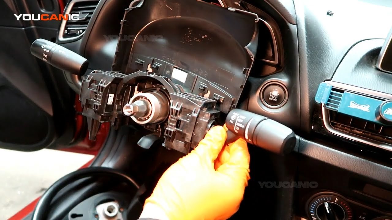

Most of the Mazda vehicles are the same. It's just a few screws.
This should help. Just skip to the part where they talk about the screws underneath the column so you can separate the top and bottom pieces of the column.
Here's another with great pics and step by step. again, Mazda 6 is most likely very similar to CX5 procedure.

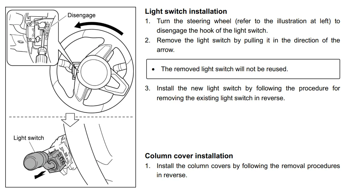

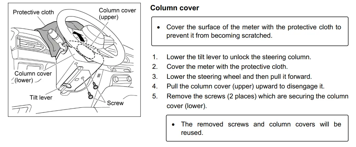

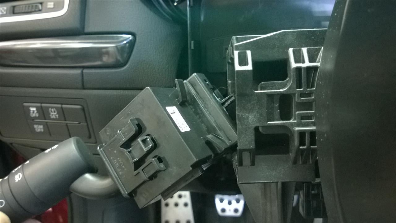

I replaced the left stalk when I added sequential low turn signals and had to add fog lights too (to fill the gaps). It was easy, and the stalk with the fog light switch was under $35 (3 years ago) from an online Mazda dealer.
I still have the guide, here are the relevant screenshots:
