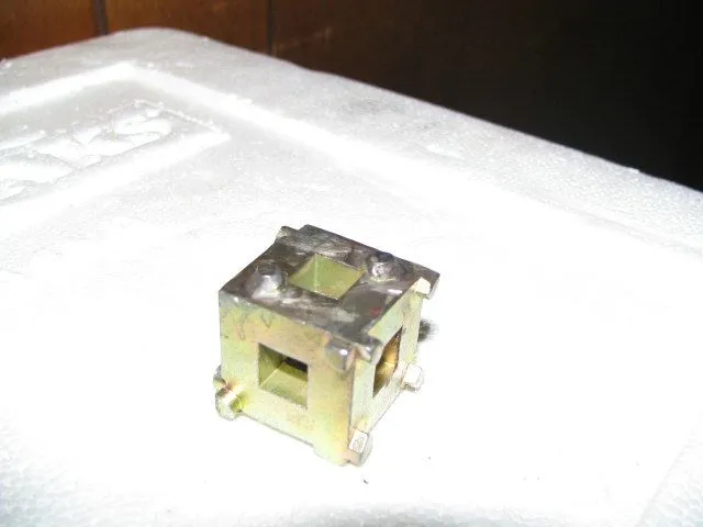

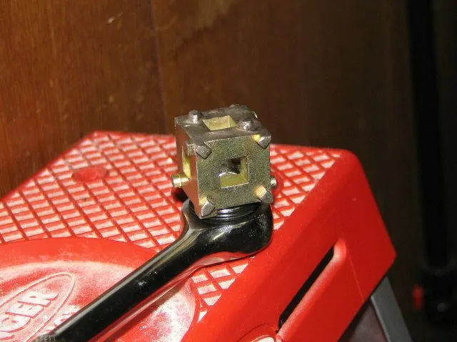

No there are two little holes on the piston you have to go to autozone or advance autoparts whatever places that carry car stuff where you live and buy a special little tool that is shaped like a cube it looks like this. Just make sure you pick the right cube kuz i didnt and i had to take a grinder after mine to make it fit. When you get the tool just put it on an extension with a ratchet find the right side of the cube and put the two little pegs in the two holes on the piston and turn it to the right and it will slowly push the piston back.
Hope this helps

and how much is this tool?

in ohio if you go to auto zone it is free, just a $50 deposit and you get it back when you return it

I bought the cube to change the brakes, what a waste of ten bucks. I ended up using as pair of vice grips just lock turn and push and the piston was back in about three or four turns.
