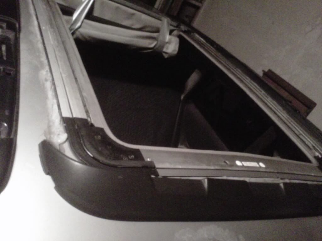

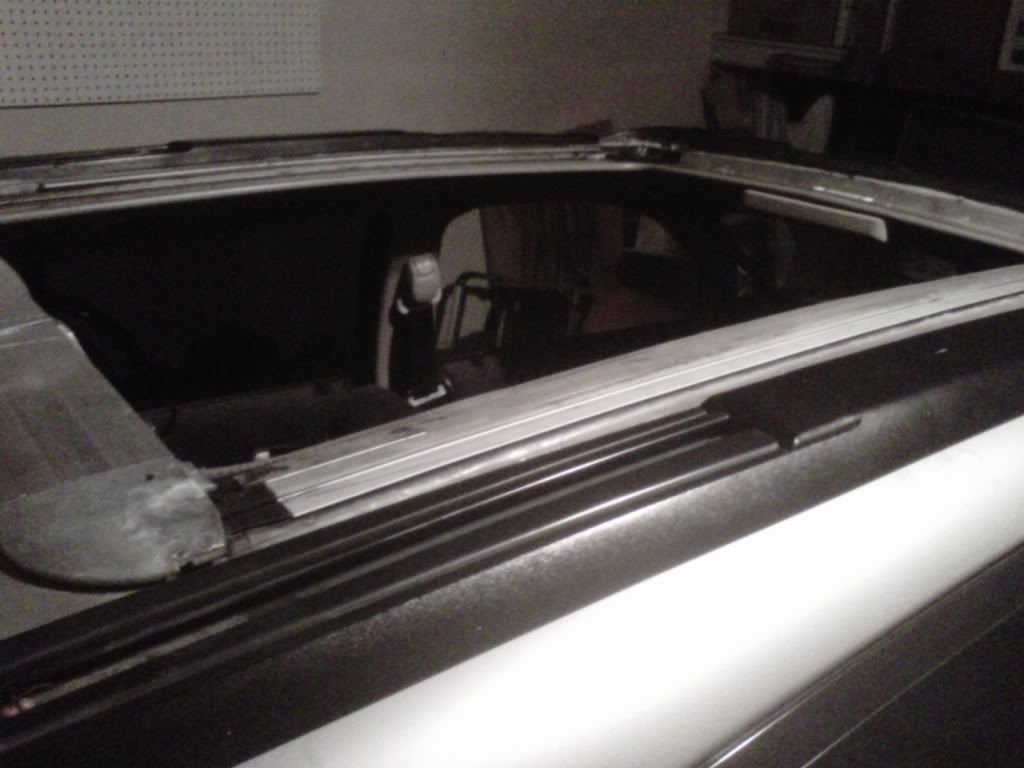

I'm going to be using the old bracket that the Folding roof went into as a frame. (I don't want to bolt or attach anything to the Roof itself, because if i screw it up I will no longer have the Hollandia 400 as an option)
Here are some pictures

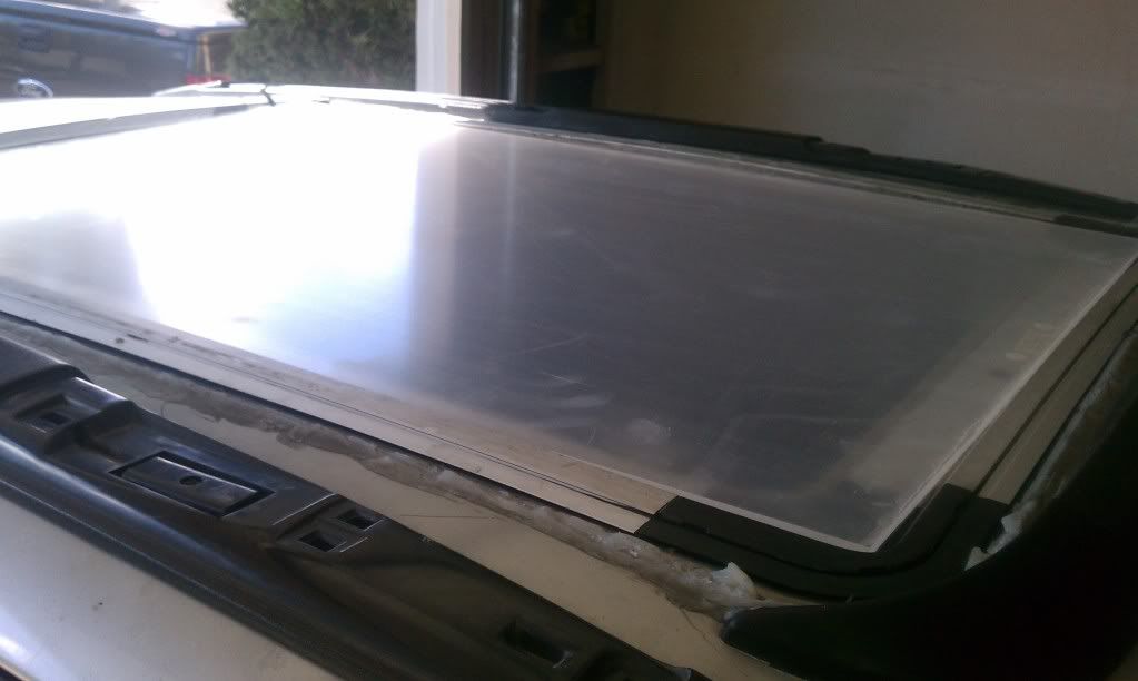

Plexiglass purchased....
Total cost so far is $46.85
Here is the sheet as it sits.
(I didn't remove the protective film it's completely clear i'm just leaving The film on until final install procedure.)
