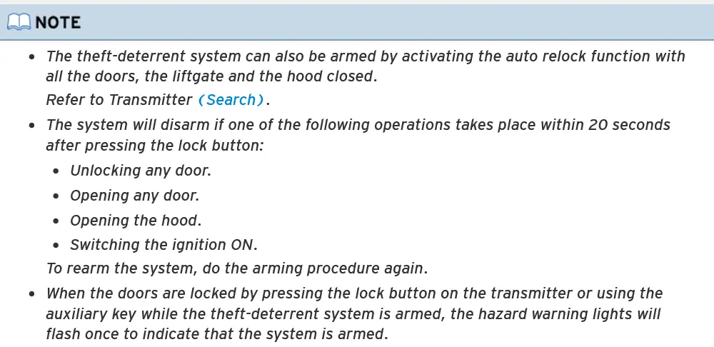

I think your car is in the anti-theft mode.
Thank you for sharing this screenshot. I have tried with a door open as well as tried to lock the car and unlock it again, but with no success. It's a very weird and annoying issue. Any chance you can point me to where you got the screenshot from?
In a few places, I was advised to try changing the car battery, so I will give that a go and will update you to share if I have any luck.

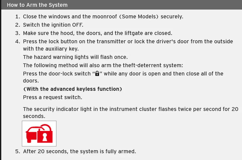

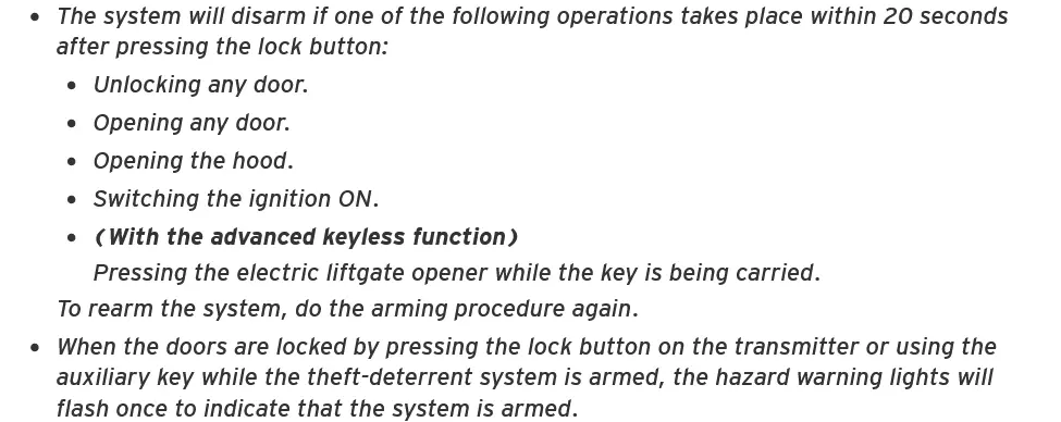

I found this link online at mazdausa.com. Try and do what it says in the manual, see if it works. "Request switch on the doors" refers to the button on the door, the button used to lock/unlock the car.
2019 CX-5 Owner manual page 141 if you use Adobe to open the PDF. At page 140 the "Theft-deterrent system" is explained and by looking at your screen, your red flash on the dashboard it's called in this manual "security indicator light".
