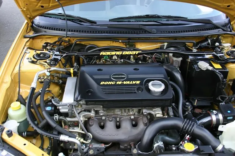

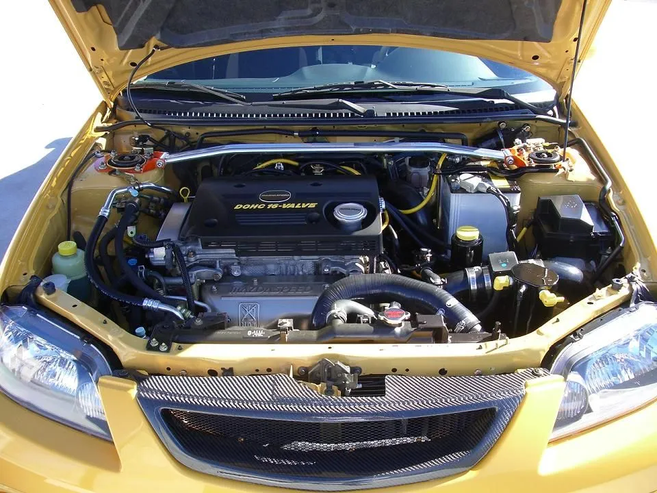

well after the thousands of dollars ive spent on her, i think im done modding. here are some pics before during and after (not much difference but hey, its better)

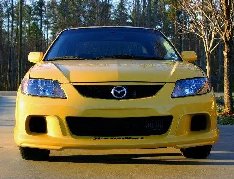

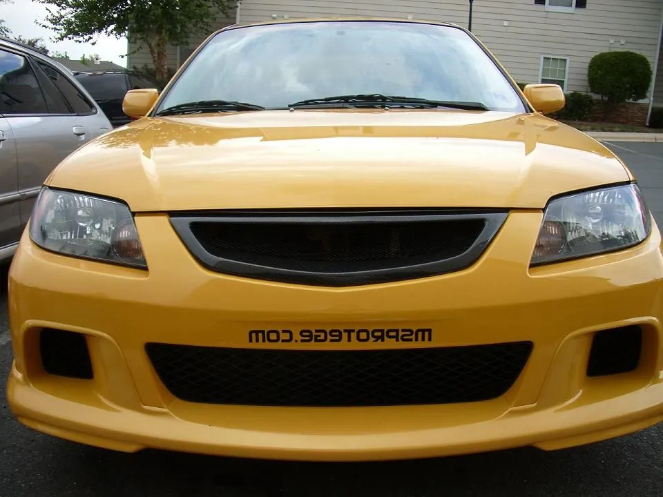

almost stock engine bay vs non stock engine bay & stock grill vs non stock grill

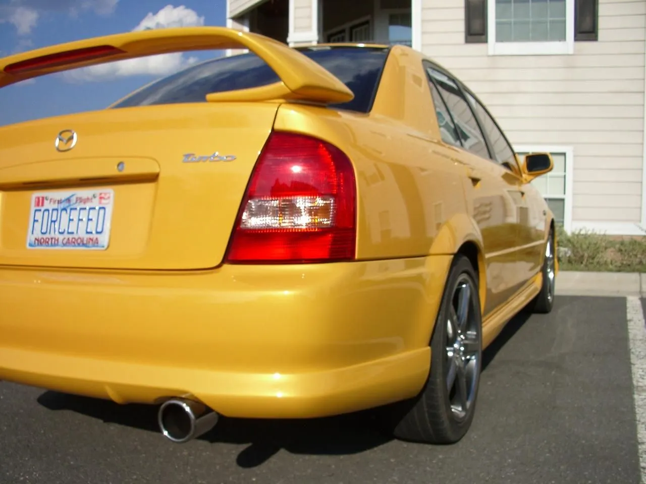

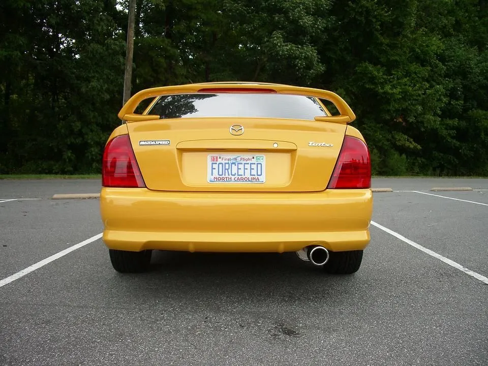

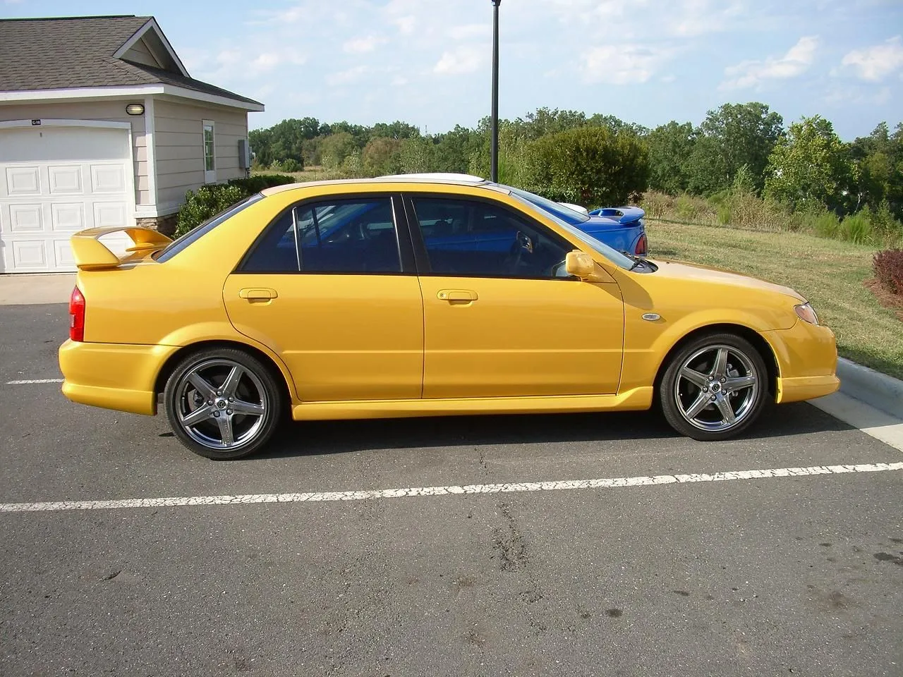

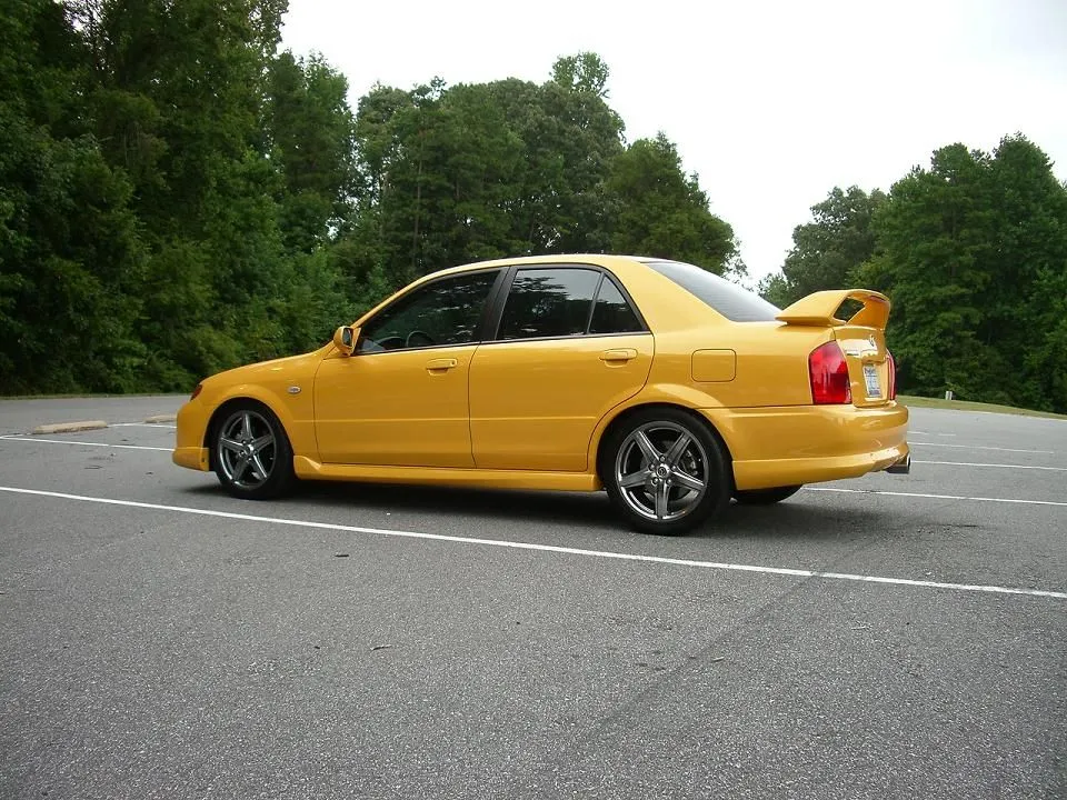

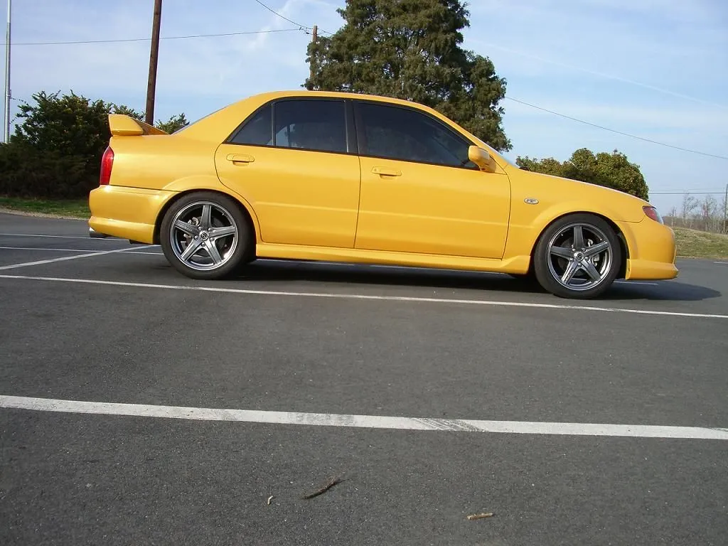

no red outs vs. red outs & stock suspension vs. Eibach Sportlines

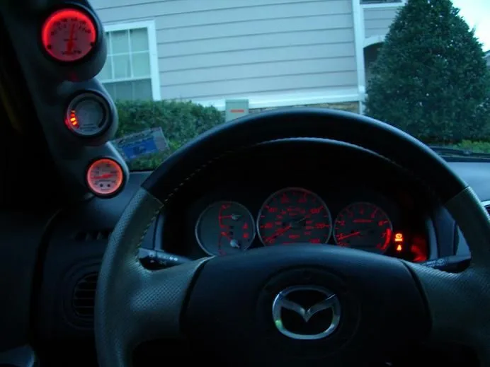

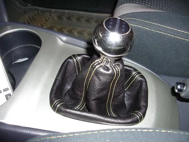

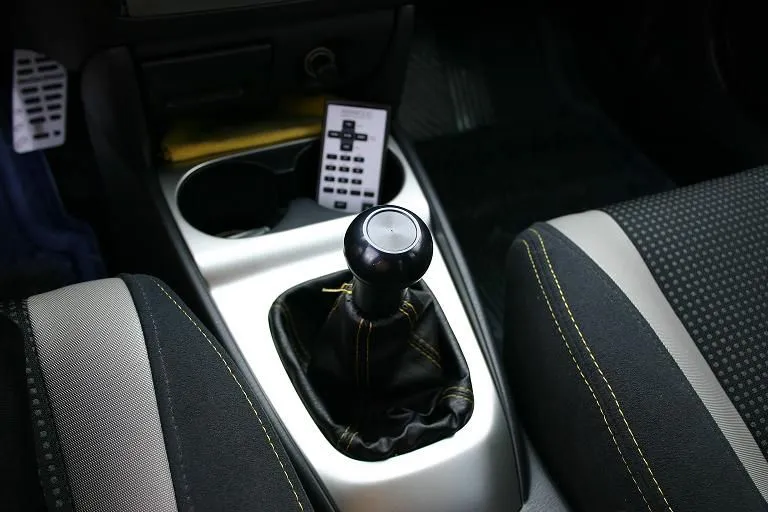

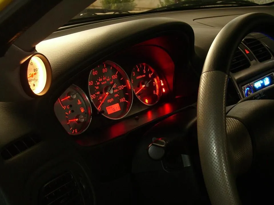

Kartoby shift knob vs. Greddy counter weight shift knob, stock shift boot vs.HPF shitf boot & single gauge pod vs. triple gauge pod

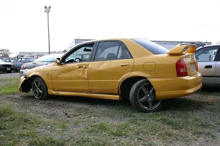

most importantly:

jesus. you get in a fight with bigfoot?
Ouch, That's gotta hurt....Sounds like your not hurt....So when's the part out begin...ahh the vultures are circling...
oh, no part out!...i love with the way the car drives and looks. im just tired of spending money on non sense 'mods'. from here on out, its going to be strickly upkeep.

think that was the before.....correct??
yea, the last pic was a year plus ago, since then ive done a lot. i was simply bored, thats all.
I see....The order of the pictures threw me off....Damn nice work...Looks clean as hell....
Noticed where the paint dots are on your front shock mounts.
Did you intend to induce 180 Deg of camber on only the right side or was it just a mess up.
The paint dot on the passenger side is supposed to be 180 Deg from where it is in that second picture..(The first one is where it should be)
The front tires are going to die quickly if that car is a daily driver..
http://www.mazdas247.com/forum/showthread.php?t=63315
3. Remember the position of the white mark on the top of your upper mounts. They are a type of camber adjustment. When you replace the new coilover, this mark must be in the same place or your suspension will force the alignment out of whack.
