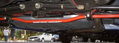

There are 2 bolts holding each sway bar bushing brackets. On the picture you only see one on each side; the other bolt is just beside the ones you see. Just remove and put your spacer between the bushing and the cross member. It takes a bout 15 min and all you need is a 3/8 ratchet with a 14mm deep socket(you can't reach the front bolt with a short one).

I would love to do this if this will eliminate the squeaking/clunking noise to our MP3s in the cold. Sounds like an easy job that even I can manage. Keep us updated as to how it turns out, thanks. :)
erm...i dunno my suspension parts super well, can you edit the pics and draw arrows with #s next to them pointing to what you're talking about?
