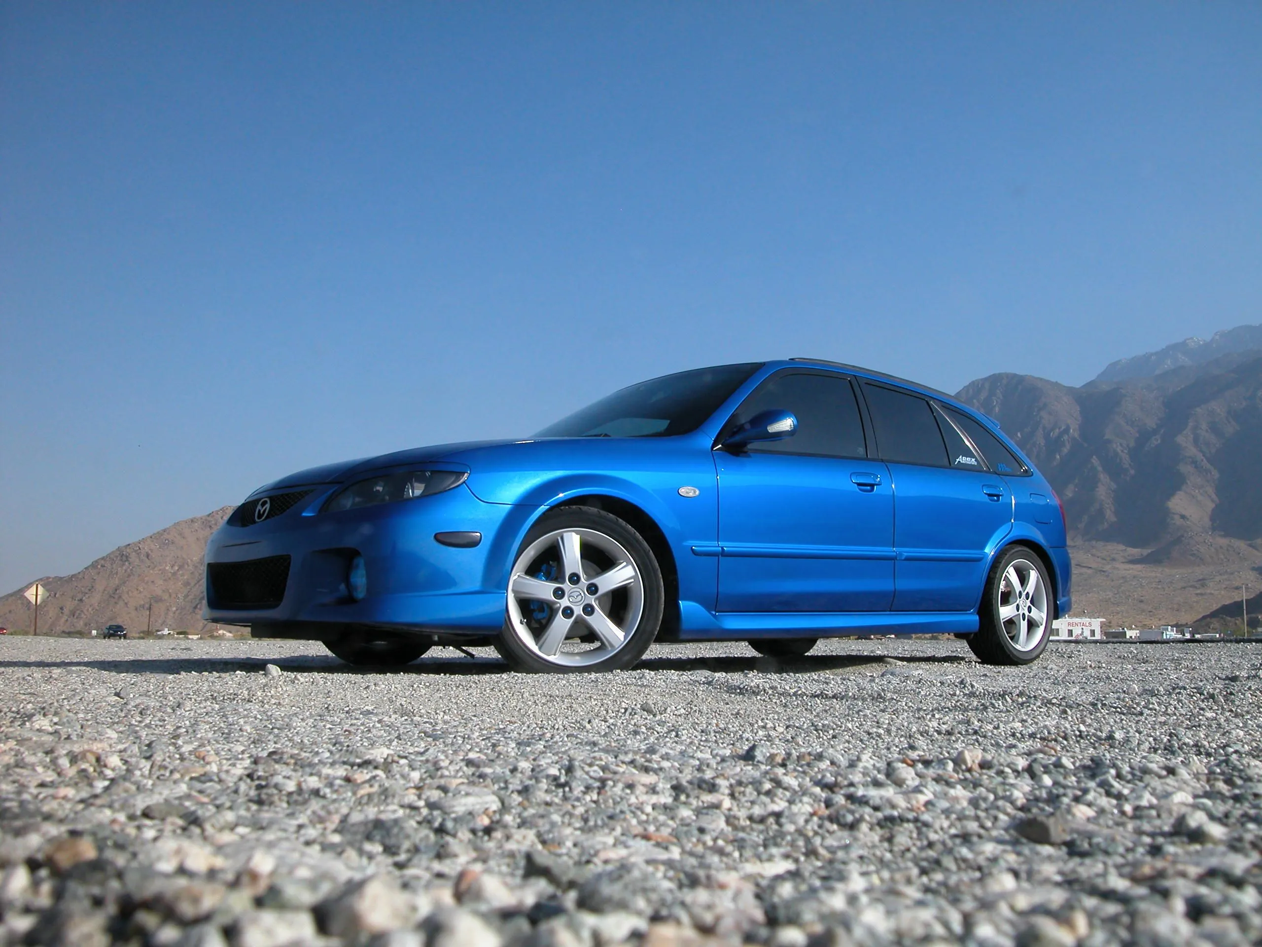

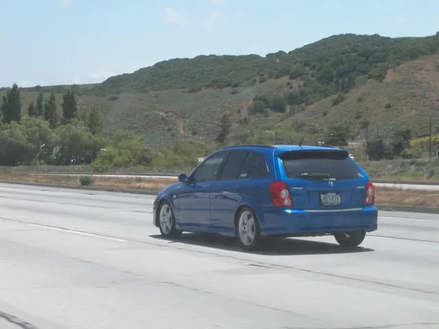

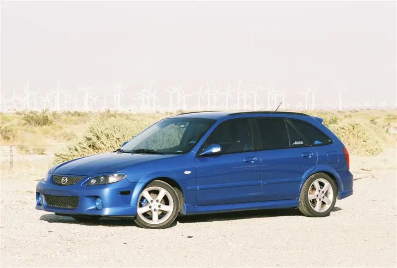

Yokahama AVS ES 100, 205/45/16 on stock rims with eibach springs
