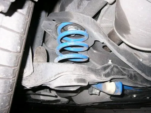

I need help indentifying these springs.
shoogerfree
07 MS3 GT Black mica
I bought my MS3 used just yesterday. I feel stupid because I just now realized that it rides so harsh that it could possibly have aftermarket springs. The dealership didn't tell me anything about this. It doesn't look very low, but now that I think about it, it does look a bit lower than stock. So I looked under it and saw that the springs are blue as well as the sway bars. Does anyone know what kind of springs and swaybars these are?

Thanks. I'm new, so I wasn't sure. Looks to be the Cobb Tuning stage 2 suspension. I'm both happy and a little disappointed. I thought I was buying a car that hadn't been messed with. It seems to ride pretty rough. But it handles Amazing. Would the Eibach pro-kit progressive rate springs make it any smoother? Should I get shocks? The car has about 33,000 miles on it and I don't know how long this suspension setup has been on the car.

Shocks and springs are rate matched to each other. The stock shock is a damper for the stock spring rate. If you increase the spring rate (which aftermarket lowering springs do) then the shock no longer damps the spring properly (eg the spring is too "strong" for the damper). This is the case regardless of how stiff the factory suspension is. Cobb's springs aren't a drastic rate increase so the shocks will be healthier than with super high-rate springs, but they're not an ideal match. To maximize performance and component longevity, aftermarket dampers should be used.
