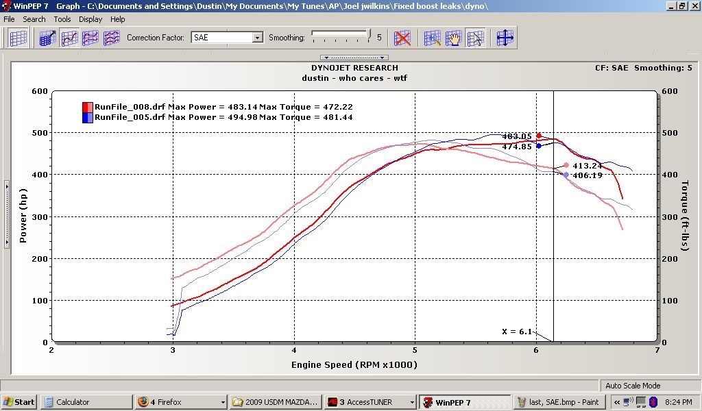

Onto pictures:
K04 sucks
That was my first dyno before I got a bigger intake and MAF housing. I was getting MAF cut on the dyno. Here's the vid from that dyno:
My second dyno was much more impressive:

The total cost of the mods on the car right now (including wheels and tires) is about 6-7k. That includes custom parts that I've had to have fabbed up. I got most my stuff used.
To address the "fragile" nature and lack of top end power, this motor has neither of those characteristics. I'm on stock block, stock clutch, and stock transmission, and my car is holding up fine. My car is making more power than identically modded STis and evos, so there's no lack of power here. The biggest things that need to be addressed with this motor are tunes and loading the motor up too soon.
I'm using the AP to tune, and I've got a solid tune on here, and it's kicking ass. I don't worry about my car at all with the tune I have on it. The other thing is making sure that you don't load the motor up too early. If too much TQ is applied to the rods while they're moving slowly (relatively), they're going to bend. My car has proven that this motor can take a beating and keep on kicking
