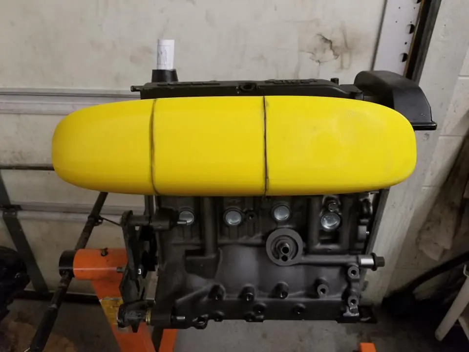

Damn, looks rad man. How's the fitment on it? Did you have to make a couple cuts to get it all to line up? How wide are the runners?
It's so large that I had to print it out in 5 pieces, so I just epoxied it together. It fits great!
Stay tuned for more info.
Definitely will, I've always wanted to do an ITB setup but it's too much math for me and my hand tools. If you could get this built I'd definitely buy one
Are you sure the material's operating temperature rating is good enough?
It's only for test fitting and flow benching. Not actually running.
