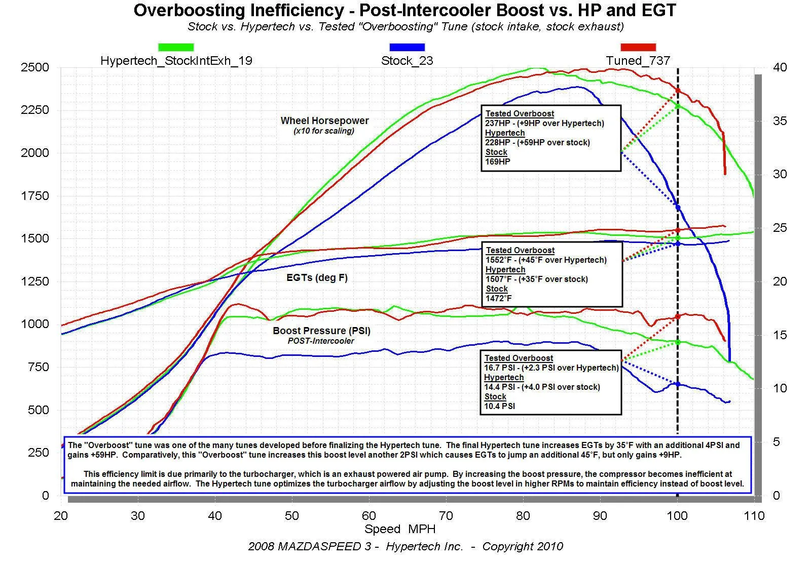

We were a bit concerned about excessive boost and turbo failures as well. We actually did an "overboost" tune to see what the effects of maintaining boost pressure all the way to redline. I have posted some specific info about this over on the Hypertech forum. Here's the link: http://www.mazdas247.com/forum/showthread.php?t=123770357
So by extending the power curve out beyond 5,800 rpm you are hitting EGT's of a bit over 1500 degrees? My question is why do you think this is safe on the stock tune and why bump it up another "mere" 35 degrees if it's already so close?
Where do you measure EGT's? The most critical place is tapping into the turbo housing itself, rather than upstream or downstream. If you are measuring EGT at the wideband 02 sensor location downstream from the turbo then the temp is cooler than up in the housing. 875 C. or 1600 F. is the point in which the center shaft becomes vulnerable to softening and failure according to the Neuspeed research. See attached.
I'm not validating their research. I don't know. But they are a reputable company with a good history that got in trouble with aggressive tunes on the K04 in VW-Audi applications. They did the right thing and dialed it back and also cautioned against exceeding 5,800 rpm.
Maybe I'm just too cautious. I just think users need to be aware of what is happening when this turbo is pushed out beyond 5,800 rpm with boost any higher than stock values. It's good that you are tapering back out there. I hope that is enough and that it does not encourage aggressive redline use, however.

Good question, and interesting info.
We measured EGTs in the exhaust manifold just after the head. The temps here should be the closest to the actual cylinder exhaust temps, and the hottest point in the exhaust system. This allowed us to keep an accurate eye on the effects that our tuning changes make to the stress that the engine is subjected to.
Relative to what is referenced from Neuspeeds findings, there are a few things to make note of before addressing the turbocharger longevity.
First, the exhaust gas temperature probes we used for our testing are MUCH smaller and faster reacting than the probes used by most gauges that are commercially sold. The probes we use have a much shorter lifespan, but for testing concerns longevity is not the primary concern. You could expect the typical EGT gauge to read 50-100F lower than the readings we are measuring, during the same test.
Second, the EGTs seen on the road are typically lower than those seen during a dyno pull. This is because of the significant increase in airflow while driving. From our own testing the peak EGT on the road was in the low-to-mid 1400F range rather than 1500F like we saw on the dyno. This is very typical from what weve seen, but thats fine for our testing purposes. If we can accomplish making a great tune on the dyno, which is worst case, then it should do great on the road.
Third, is that exhaust gas temperature and heat energy are not the same thing. A 70mph cruise on a flat and level road may require 50HP, and with an AFR at stoiciometric, the EGTs can sit around 1500F. Compared to a full throttle pull in 4th gear at 250HP and 1500F, the heat energy is much different. Its this heat energy that would cause problems for a turbocharger. An easy way to assess heat energy is EGT at HP and RPM. All three are relative to the heat being pumped out of the engine.
All of these considerations absolutely determined our tuning changes for boost. To further explore the Overboosting_Inefficiency chart (see attached), you will notice that our tunes peak EGT occurs just before 90mph (~5700RPM) and then trails off. Not only do the EGTs decrease, but boost and power are also decreasing. The Tuned_737 run maintained 2psi more boost which increased EGTs by 45F and gained 9HP (all at 100mph). This overboost tune not only shows that the additional boost does not provide expected power gains, but also increases the heat energy dramatically. So, in comparison, our final tune decreases the boost in the higher RPMs which keeps the turbo compressor in its optimal efficiency range without excessive turboshaft speeds, and reduces the heat energy that the turbine is exposed to.
Now, all of this theory sounds great on paper, but our tune was THOROUGHLY tested on our own vehicle long before it was even released for Beta testing. Our car saw over 1100 full throttle dyno pulls, and over 8000 miles of testing which proved our tuning theories correct.

You are correct about the turbo efficiency, and we tested to find the peak efficiency of the factory turbo. The HP curve with our tune holds at roughly 250HP form 5000 RPM to 6000 RPM, and then trails off quickly. The turbo reaches its peak efficiency and holds there for roughly 1000 RPM. Instead of pushing the airflow from the turbo in the higher RPM's by holding the boost steady, we had to roll it off to keep from superheating the air and overspinning the turbo.
Maintaining boost out to redline would make an additional 10-20 HP, but at the cost of 200 deg more EGT. So we didn't do that.
