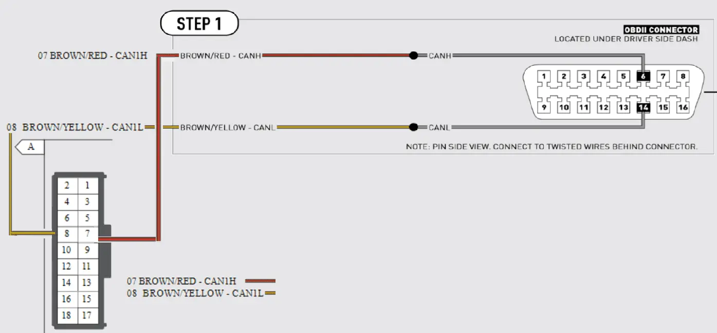

Step1
what makes the gauges work. I soldered 2 metal leads that came off of capacitors and inserted them into my obd port at these 2 locations. I tried to get them in the backside but they came lose after remounting the obd port. so sticking in the front is working and easily removed if needed.

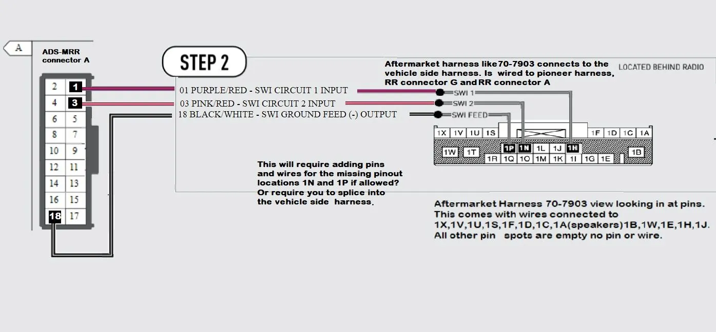

step2
this is what interfaces with your steering wheel controls

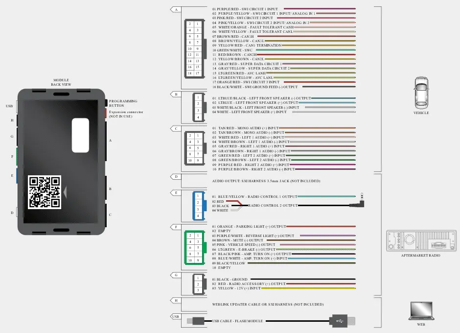

step 3

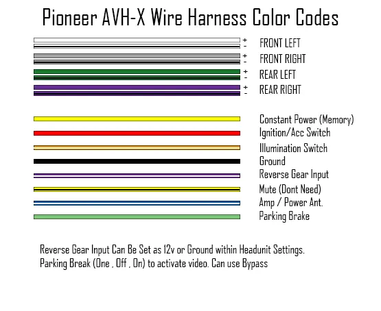

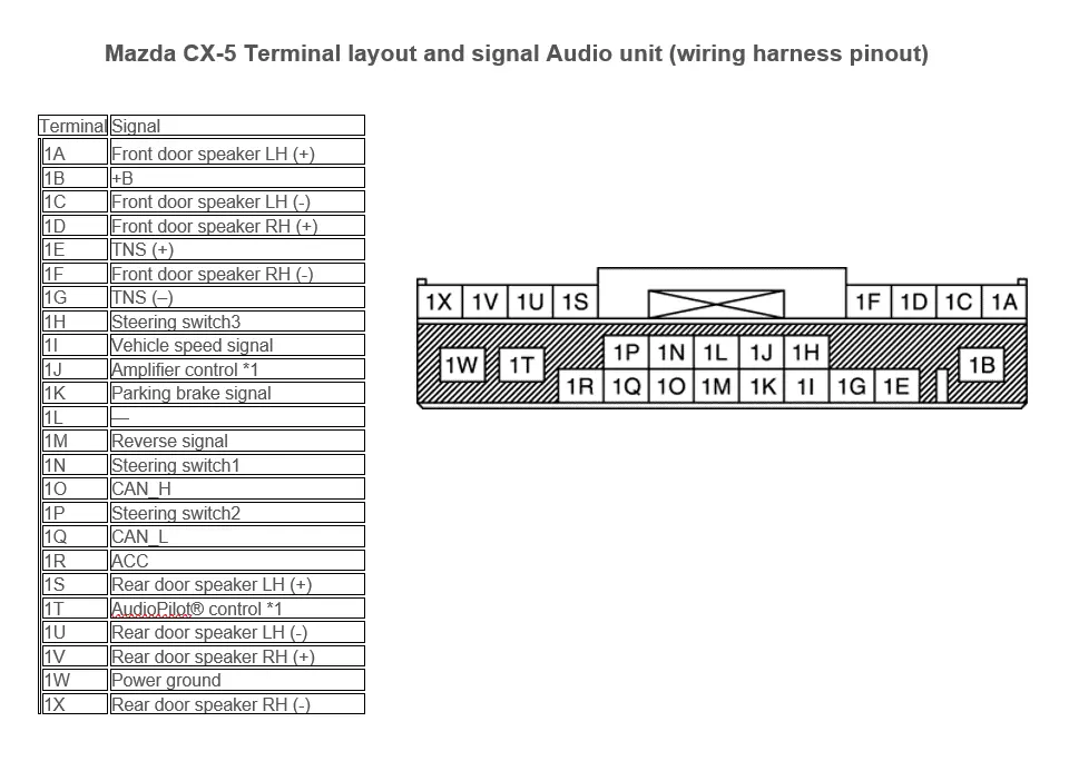

getting the remaining wires connected for specific to installing the maestro unit the 2 wires from connector g are what gets power to the unit. the other items are specific to a pioneer head units setup so please check you head unit to make sure they are the same..
