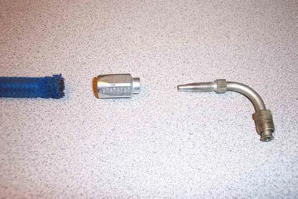

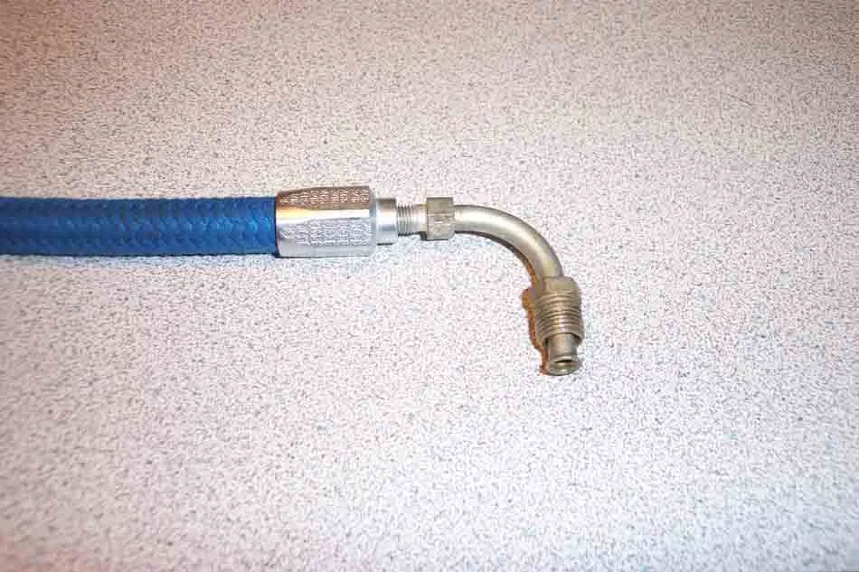

Here's an example of my oil feed line. The large section winds on to the hose counter-clockwise until the hose is fully seated into it. Then the fitting (in this case a 90 degree elbow) threads into that. I used a flaring tool on my dremel to shape the end of the hose to better accept the fitting.

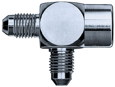

looking over your parts list, I run into some trouble when I want to T off for my oil temp sensor
with the T you used, or the pic on the summit racing site:
I think my temp sensor would block oil flow
