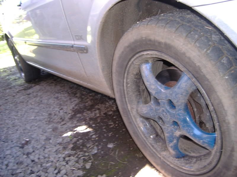

so i think it should be alright but then again my rims look like this now:
but thats more from neglect and living on a dirt road
how you gunna do that to me haha. hmm if yours were cleaned would they look like they did in the begining. but you think i should be ok just painting them tomorow then...your answer kinda sketches me out! ha
