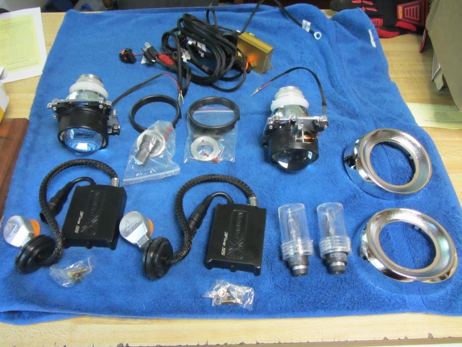

PREFACE: What makes up an HID retrofit kit
1) Projector. This is the headlight lens, which has a cut off inside of it so it doesn't blind other drivers on the road. Bi-xenon projects have the capability of lowering the cut-off, so you have a high beam and low beam.
2) HID bulb. Self explanatory. From my understanding the bulbs come in either H1 or D2S, which just refers to the plug for connecting them. Colors vary, but OEMs use 4300k and the most common is 5000k.
3) Ballast. This is the power supply for the bulbs. They come in 35w and 55w. 55w will make your bulbs brighter but will burn them out more quickly. Bulbs are expensive as hell, so go with 35w.
4) Harness. Most kits come with a control module and wiring harness, it's all plug and play.
5) Shroud. This is they fancy silver piece of plastic that goes around the projector lamp. It's a dress up item, so you can pick whatever you want to fit your style.
As far as wiring is concerned, the kits are straight forward. The ballasts are connected to power, ground, and one gets plugged into the OEM headlight bulb connector.

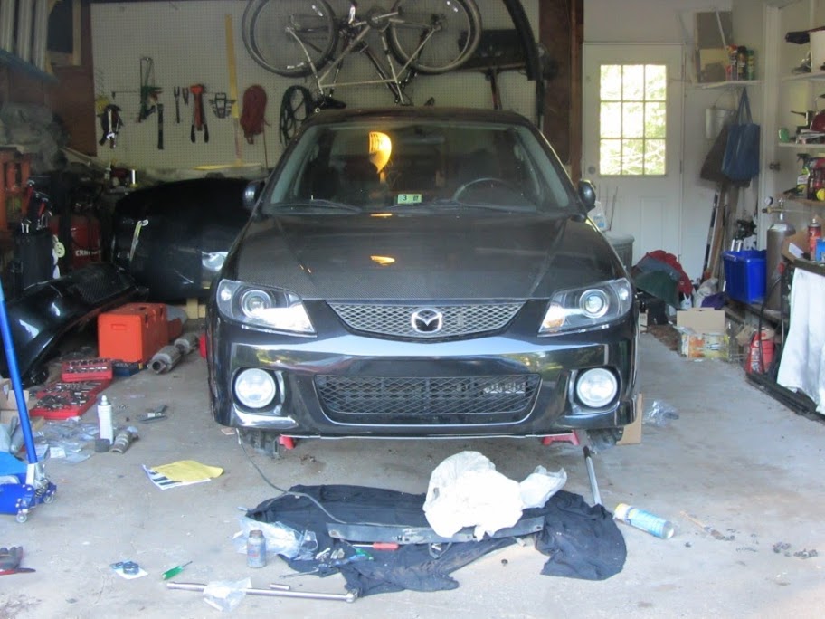

STEP 0: Mark your current headlight aiming
1) On a flat surface, pull your car within 60 feet of a flat wall, garage door, etc
2) Use painters tape to mark where your headlights currently sit and mark the cut offs
3) Driver's side will sit slightly lower than passenger side
4) These instructions might be wrong, but you can look up how to aim headlights in the FSM or online.

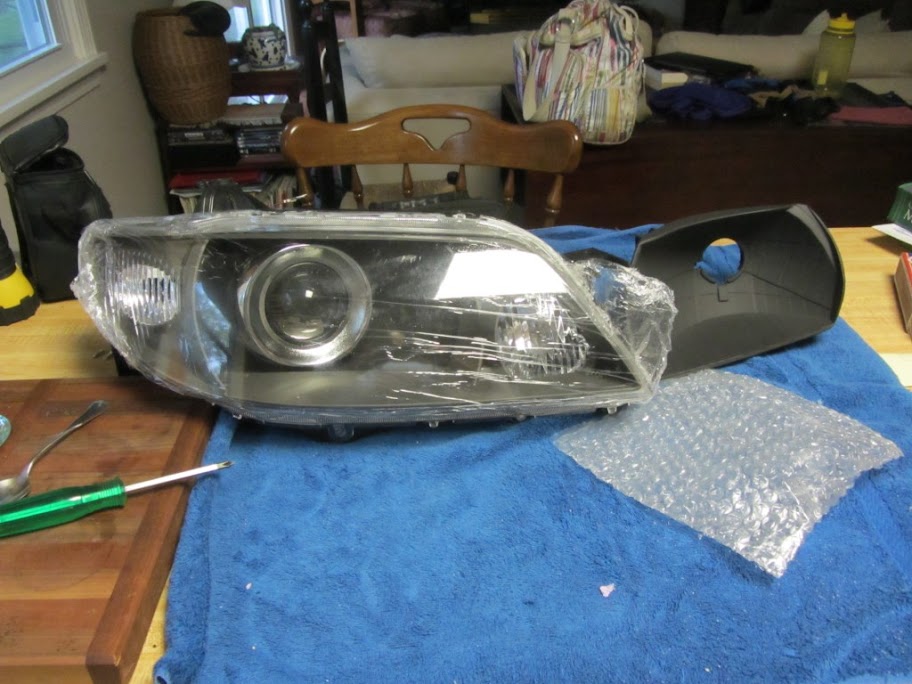

STEP 1: What kind of headlights do you currently have?
P5 lights have two bulbs, one for high beam and the other for low beam. The retrofit kit you want is for low-beam, or you can use bi-xenon and just cut the wires for cut off activation.
MSP and regular Protege have one bulb, an H4 that takes care of high and low beam. You need a bi-xenon retrofit kit.

Bi-Xenon Morimoto Mini Stage III Kit (H1): Don't know much about this kit, but I'm pretty sure it's identical to the D2S kit that I bought, except it comes with H1 style bulbs instead of D2S.
Bi-Xenon Morimoto Mini Stage III Kit (D2S): This it the kit I purchased. I've been happy with it with the exception of the ballasts which were flickering and sometimes shut off. TRS said the ballasts were recalled and they sent me replacements free of charge and the new ballasts have worked great. It is basically a plug-n-play kit.
Bi-Xenon FX-R Stage III Kit: This is a more advanced kit. Installation will be similar to the P5 install I linked at the beginning and will require cutting and fairly precise measurements to make sure they are level.
SUGGESTION: If you're buying from TRS, I would suggest upgrading to the Denso ballasts and the Philips bulbs. I've been having difficulties with the Moriomoto ballasts and have heard nothing but good things about the Denso ballasts. You get what you pay for.

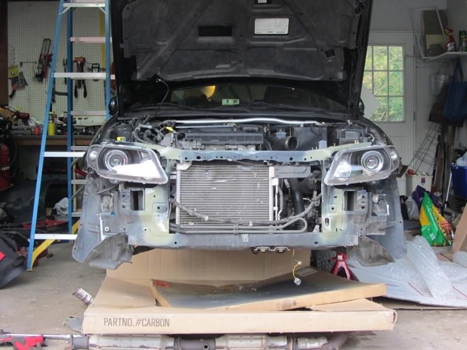

STEP 3: Remove your headlights
0) Pre-heat your oven to 200 degrees. You can do it now, or wait until you have the headlights out of the car.
1) Remove your front bumper

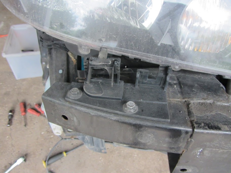

2) Remove the bumper support brackets. They look like the picture below, only yours likely won't be broken from a front end collision.
3) Remove the three bolts holding the headlight to the car
4) Remove all plugs for the lights themselves
5) Pull out the headlights

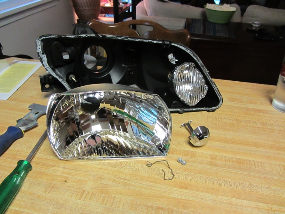

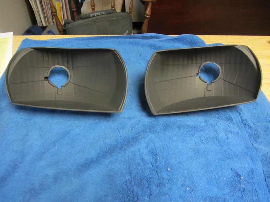

STEP 4: Pull apart your headlights
1) Remove all of the philips head screws from the back of the headlight assemblies
2) Be sure to get all of the screws, moisture escape tubes, etc. Everything in red in the picture below should be removed.

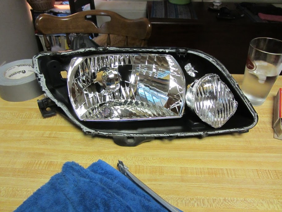

3) Put cookie sheet in the oven, cover with a towel, and put HL on the towel. Bake the headlight for 10 minutes
4) Pull out the headlight (use gloves), and pull them apart using a flat head screwdriver. Take your time to pop the tabs and work the two pieces loose. If the glue isn't releasing, put the light back in the over for a bit more.
5) Remove the rest of the internal components (bezel, reflector, etc)

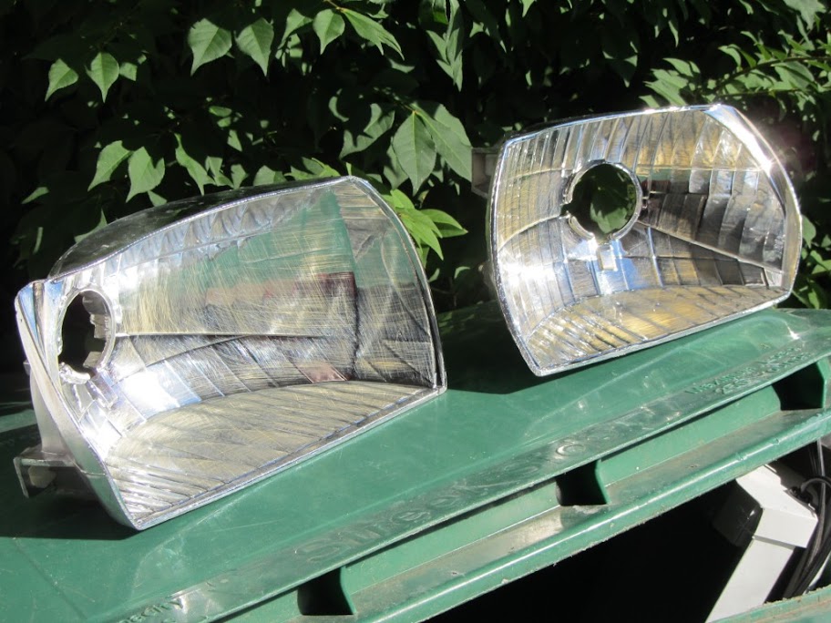

STEP 5: Paint the reflector (optional)
1) Sand the reflector, doesn't have to be complete, but just rough it up so the paint will stick
2) Wash the reflector and let it dry
3) Hit the reflectors with two coats of high temp primer and 2-3 coats of flat black high temp paint.

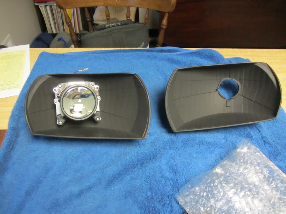

STEP 6: Mock up the retrofit
1) Reinstall the reflector and turn signal
2) Layout your HID retrofit kit and take inventory
3) Read the instructions included with your HID retrofit kit
4) (Bi-xenon only step) Test the cut-off on your projector and exercise it to make sure it doesn't get stuck. Using a piece of wire, hook the positive to a power source (9V battery, or your car battery). Now hook another piece of wire to the negative side and tap it to the negative terminal on your power supply. Do this a bunch of times to make sure the cut off works. NOTE: The bi-xenon kits from TRS have connectors that you put together that are weather tight. These connectors are pretty crappy and can vibrate apart a few months of driving. I suggest cutting the wires apart and using some all weather quick disconnects.
5) (Optional) If you look at the projector lens from the side, you can see there's a black four-legged bracket that holds the lens onto the housing. There are huge holes leaving the innards exposed. It was suggested somewhere in some video to cover those holes with aluminum tape to prevent light from spilled out into the headlight housing. I'm not sure that's true, but I did it any ways. It's optional, it was tedious to do it, so I'll leave it up to you.
6) Dry run your install in headlight housing to make sure everything lines up, fits, etc. Depending on your shroud, kit, etc you might need to trim some pieces of the shroud or headlight housing to make everything fit.
7) (Optional) It is suggested in the kit instructions that you use JB Quick to install the shrouds onto the projectors. I did this, but it's optional. The risk is eventually the shroud might work its way loose from the projector and flop around inside the headlight, forcing you to remove everything to re-seat it. Since that's a pain, I went ahead with the JB Quick for the shroud. The other risk is if you do use the JB Quick, you'll never be able to remove the shroud again. This will take about 30 minutes to cure.

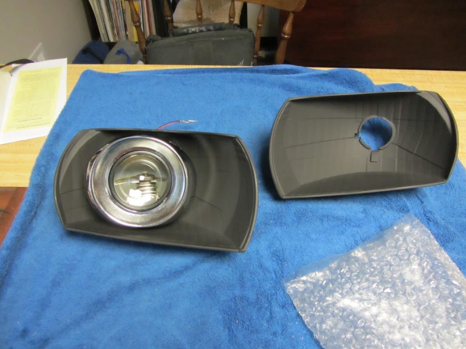

STEP 7: Install the projector for good
1) Follow the instructions for your kit for the permanent install.
2) For the D2S kit I bought, the only difference between this and the mock up was using channel locks to really tighten down the locking nut on the back of the projector housing.
3) Double check everything, make sure the projector is night and tight. It will still wobble some (if you're using the Morimoto Mini kit), but that's normal.

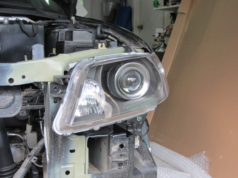

STEP 9: Test the lights
1) Install your HID bulbs
2) Throw the headlights onto your car and replace the 10mm bolt back into the radiator support bracket for the lights.
3) Connect the bulbs to the ballasts
4) Turn on your headlights
** Verify they work, if they don't, start troubleshooting your wire connections
5) (Bi-Xenon step only) Flick your high beams on and off to verify the cut offs are working
6) If everything is working, bolts everything back up and reinstall the front bumper. If everything is not working, you can go through the FAQ on the TRS web site or submit questions to their forum or customer support.

Thats a pretty good writeup! Very details and informative. Prolly one of the best retrofit write ups I have read. Only thing I would like to add is the chrome reflector part of painting. With or without primer it is best to remove all the chrome from those areas. Some never have issues and some do but the chrome will cause the paint to flake and peel under heated conditions. Like I said, not all the time but I have seen it happen.
Other than that, hell of a job bro!! Looks good!
Can't remember but I think I used high heat primer and paint for the chrome reflector. Haven't had any issues after two years.
Yea, some people never have a problem with it and some do, heat primer would defiantly help out for sure though! I had a set before back in my days of not knowing anything about retrofits I did not do anything just used paint. Never once had a issue, then I seen someone with a MS3 and they had theirs done by someone about 3 months before and it had paint peeling. Could have been the paint used I dont know, but after all the learning I have done, I just remove all the chrome. haha
