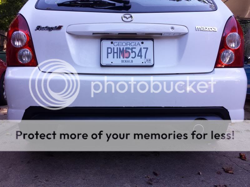

How to plastidip rear valance?
Found a bunch of threads talking about it and showing up finished product but is there a how to anywhere? Should I get the dip of the spray?
