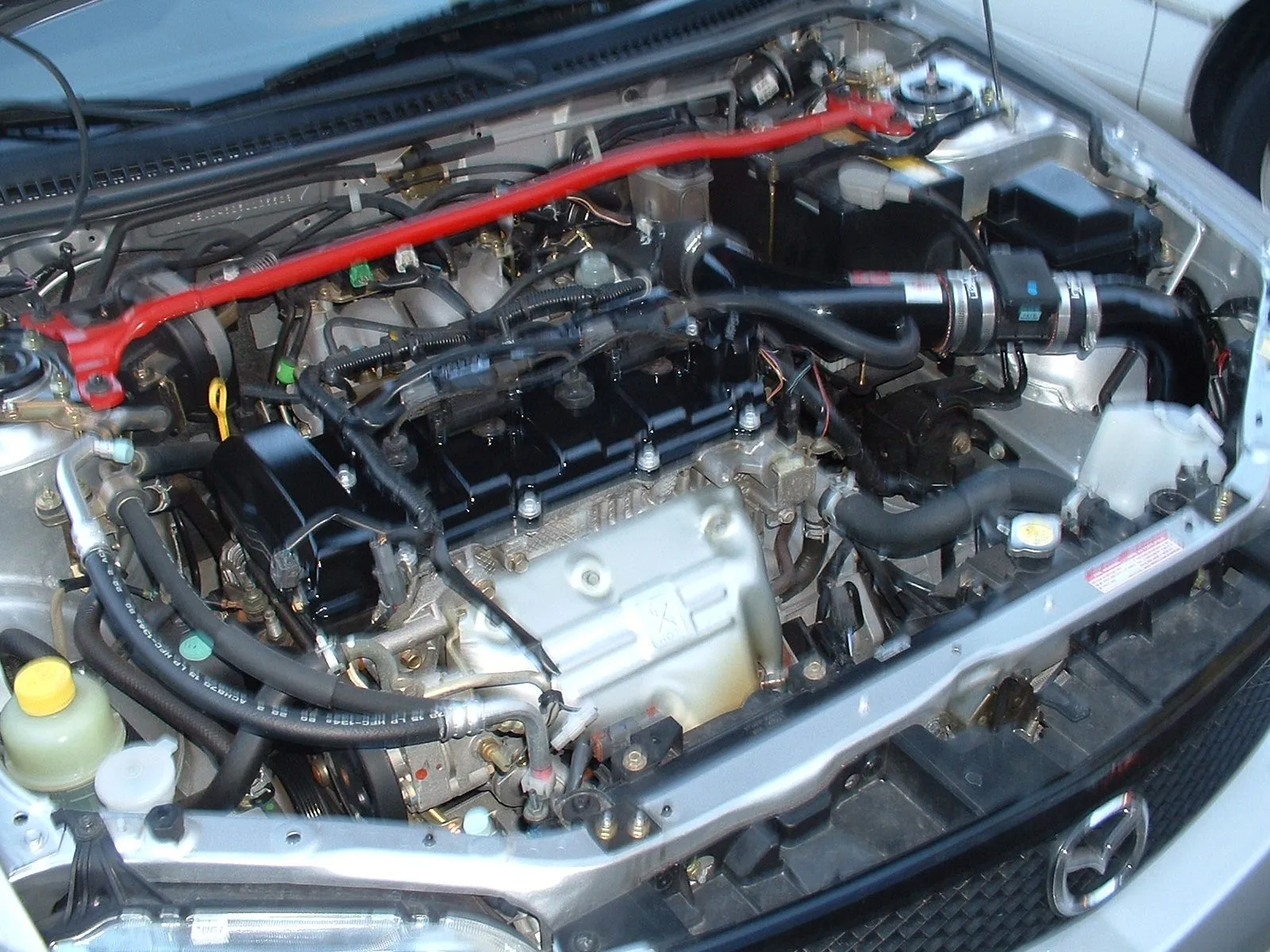

Here is my old one. I am doing my new one red:
YelPro03 said:
So what's with the Spam on the stut tower brace? Heating up lunch?
hahahaha.. it makes the car go faster!

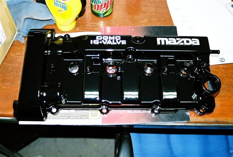

Did my valve cover (black) and heat shield (chrome) tonight at work. Took my good ole time prepping, primering, and painting (even baked them between coats) and then finished them with high-temp clear. This is where the problem is.......the clear actually dulled the gloss and made the heat shield almost look sunlight silver! That, plus baking the parts made it damn near impossible to sand the paint off of the "16 VALVE DOHC" and "MAZDA" on the valve cover, so I had to paint over it again! Has anyone else had problems applying clear coat?
Upon further review, the valve cover doesn't look too bad, but the heat shield is dicolored at the bottom.
Sorry about the pic quality......

holy crap, im gonna try this in white. Ill be sure to use a clear coat though so it looks like it came like that from the factory.
white will get dirty before the day is over...
good luck with that.

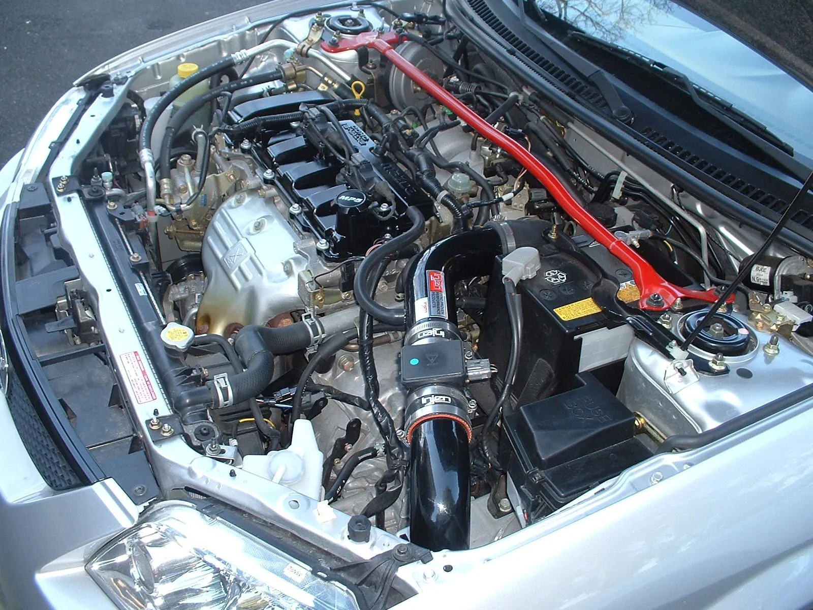

Valve cover comes very easily and quickly. Duplicolor metal cast in the blue anodized is real close to laser blue and it with stands the heat. Mines painted black with a blue Mica.

Yes, its black with a blue metal flake. Its the same paint that I did my hood, roof & wing with. I also painted my rims and a stripe on the bottom of my car with this same black paint. It kind of all ties it all together.
