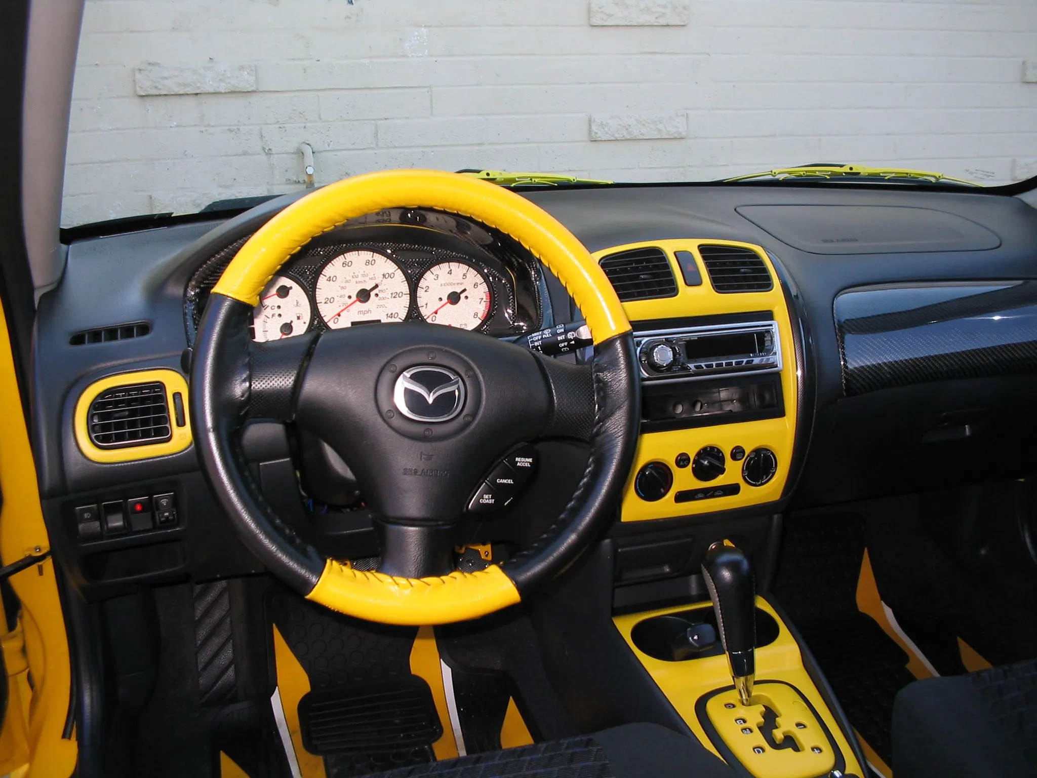

check out my interior
chicana28 said:
i painted my interior... i should get some pictures!! hmmmmm (thought)
what pieces do you wanna remove man? It's not really hard... I didn't have help I just kinda went ahead and did it myself.. I did ask for help on the door handles though..
